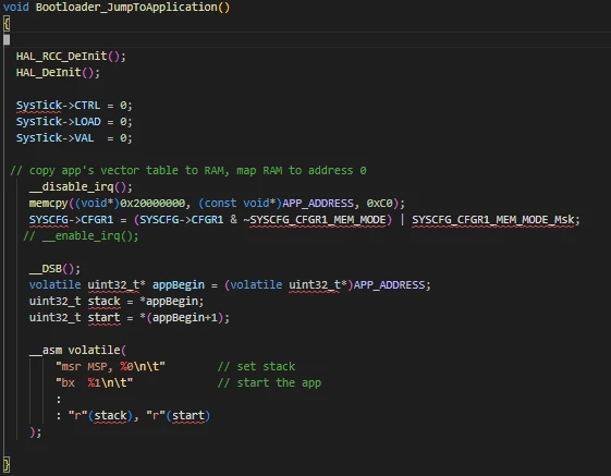

Dear Members,
I'm using the STM32F030CC controller for my RTOS-based project and currently developing a bootloader for it. The application code has been relocated to 0x08004000. The bootloader successfully jumps to the application, but after initializing all peripherals (GPIO, timers, etc.), calling `HAL_GetTick()` returns a `uwTick` value of 0.
This is the fuction iam using to jump from bootloader to application. when i try to do _enable_irq(); the jump fuction is not working .
am i missing anything?

Hello @Sid_sid and welcome to the community,
First, please use </> button to paste your code instead of sharing screen shots.
Second, Did you remap your vector table (VTOR) to the new Flash address 0x08004000?

You are disabling interrupts which prevents systick from occurring.
For working code on how to jump to the bootloader, see here: It can be easily modified to jump instead to your application. Note the section where it disables interrupts in the NVIC registers. You likely need something similar

Oct 8, 2024 11:20 AM UTC
when i try __enable_irq(); in application, the code stuck there.
But when i tried a basic led blink project as an application code ,that was worked and the uwTick is icrementing.
This is the bootloader jump function.
void Bootloader_JumpToApplication(uint32_t address)
 // disable global interrupt
 __disable_irq();
 // Disable all peripheral interrupts
 HAL_NVIC_DisableIRQ(SysTick_IRQn);
 // main app start address defined in linker file
 extern uint32_t _main_app_start_address;
 uint32_t MemoryAddr = (uint32_t)&_main_app_start_address;
 uint32_t *pMem = (uint32_t *)MemoryAddr;
 // First address is the stack pointer initial value
 __set_MSP(*pMem); // Set stack pointer
 // Now get main app entry point address
 pMem++;
 void (*pMainApp)(void) = (void (*)(void))(*pMem);
 // Jump to main application (0x0800 0004)
 pMainApp();
 this is the starting of application code:
int main(void)
 /* USER CODE BEGIN 1 */
 // Copy interrupt vector table to the RAM.
 volatile uint32_t *VectorTable = (volatile uint32_t *)0x20000000;
 uint32_t ui32_VectorIndex = 0;
 for(ui32_VectorIndex = 0; ui32_VectorIndex < 48; ui32_VectorIndex++)
 VectorTable[ui32_VectorIndex] = *(__IO uint32_t*)((uint32_t)FIRMWARE_START_ADDR + (ui32_VectorIndex << 2));
 __HAL_RCC_AHB_FORCE_RESET();
 // Enable SYSCFG peripheral clock
 __HAL_RCC_SYSCFG_CLK_ENABLE();
 __HAL_RCC_AHB_RELEASE_RESET();
 // Remap RAM into 0x0000 0000
 __HAL_SYSCFG_REMAPMEMORY_SRAM();
 // __enable_irq();
 /* USER CODE END 1 */
 HAL_Init();
 /* USER CODE BEGIN Init */
 /* USER CODE END Init */
 SystemClock_Config();
 /* USER CODE BEGIN SysInit */
 /* USER CODE END SysInit */
 MX_GPIO_Init();
 MX_DMA_Init();
 MX_USART1_UART_Init();
 MX_TIM17_Init();
 MX_ADC_Init();
 MX_I2C1_Init();
 MX_TIM15_Init();
 MX_USART5_UART_Init();
 MX_CRC_Init();
 MX_USART3_UART_Init();
 MX_RTC_Init();
 MX_USART4_UART_Init();
Oct 8, 2024 12:17 PM UTC
Probably because you did not disable interrupts correctly.
