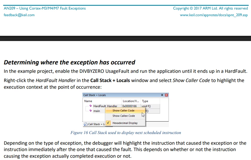

STM32CubeIDE gives you a call tree showing where the fault occurred - can Keil do that?
If it turns out that the location is consistent, then set a breakpoint just before that point to see what's happening...
PS:
Yes, it seems that it can:
https://www.keil.com/appnotes/files/apnt209.pdf#page=17

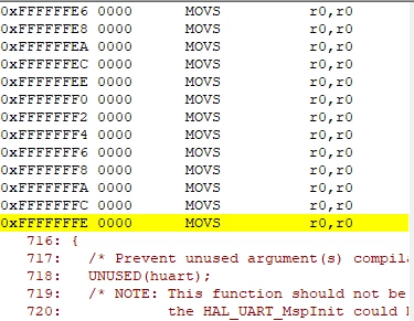

tfdeAuthor
Jul 30, 2025 8:44 AM UTC
Thank for the tips.
It if i use this technique here is what i get :
It seems like the program go out of memory bound, i dont get how commenting a file change the issue of that.
