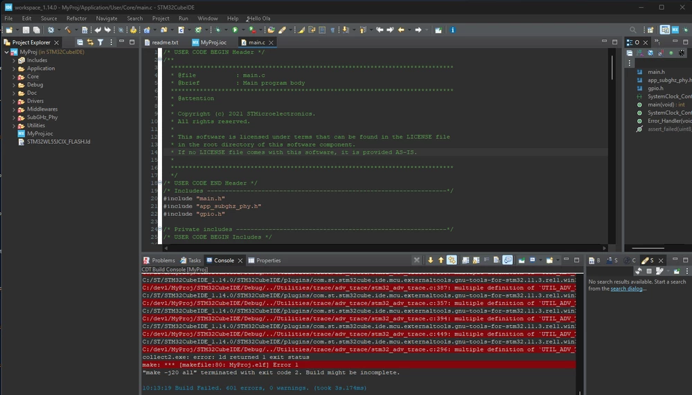

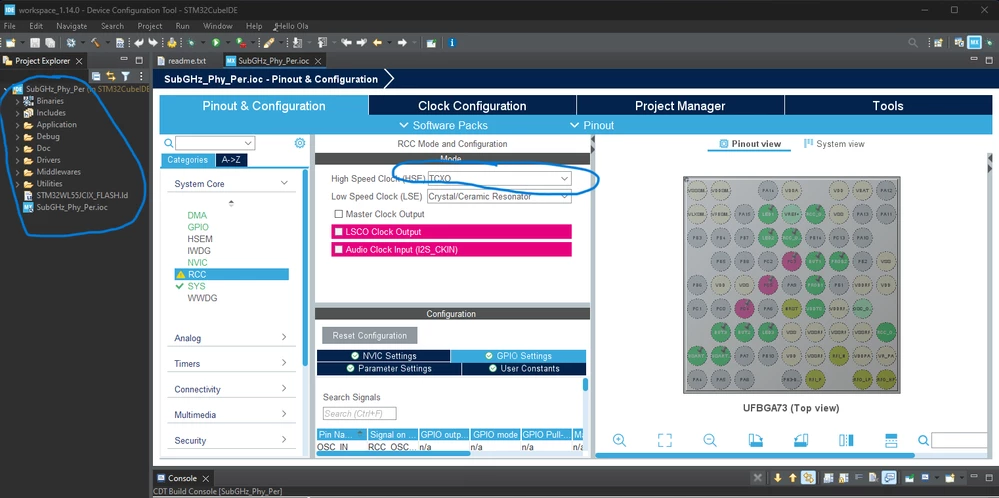

If I create a project based on the SubGHz_Phy_Per project generated by the Example Selector using STM32CubeMX. A project is created which builds fine and can be programmed and even debugged.
See image below
In the project explorer pane highlighted in blue you can see the default data structure that STM32CubeMX generated when the Example Selector option was used by default.
When the project is generated. I can edit the source files and build the project successfully.
The problem however arises when I renamed the project, which I want to be able to do in order to make the project name more relevant for our project.
I can successfully rename the project by right clicking on the Project Name in the project explorer window and then rename. And after the renaming process I am still able to edit source files, build and debug without any issues.
The only issue now is that, any subsequent changes to the configuration file after renaming the project breaks the project. For example using the image above if I change the RCC configuration highlighted in blue, meaning change High Speed Clock(HSE) option from TCXO to Disable and immediately back to TXCO and save the configuration. After the project is regenerated then I get the following.
In the Project Explorer two additional folders are added to the top level tree structure namely Core and SubGHz_Phy. There are other folders that are generated in the Middleware and the Utilities folder which is not in the initial generated project.
When I was previously trying to reproduce the problem I was not changing the project name which was why I could not reproduce the bug however when I first discovered the bug I had already changed the project name.
Below are logs showing the issue.
C://devl/MyProj/Drivers/STM32WLxx_HAL_Driver/Src/stm32wlxx_hal_pwr_ex.c:632: multiple definition of `HAL_PWREx_EnableFlashPowerDown'; ./Drivers/STM32WLxx_HAL_Driver/Src/stm32wlxx_hal_pwr_ex.o:C:/devl/MyProj/STM32CubeIDE/Debug/../Drivers/STM32WLxx_HAL_Driver/Src/stm32wlxx_hal_pwr_ex.c:632: first defined here
C:/ST/STM32CubeIDE_1.14.0/STM32CubeIDE/plugins/com.st.stm32cube.ide.mcu.externaltools.gnu-tools-for-stm32.11.3.rel1.win32_1.1.100.202309141235/tools/bin/../lib/gcc/arm-none-eabi/11.3.1/../../../../arm-none-eabi/bin/ld.exe: ./Drivers/STM32WLxx_HAL_Driver/stm32wlxx_hal_pwr_ex.o: in function `HAL_PWREx_DisableFlashPowerDown':
C:/ST/STM32CubeIDE_1.14.0/STM32CubeIDE/plugins/com.st.stm32cube.ide.mcu.externaltools.gnu-tools-for-stm32.11.3.rel1.win32_1.1.100.202309141235/tools/bin/../lib/gcc/arm-none-eabi/11.3.1/../../../../arm-none-eabi/bin/ld.exe: ./Utilities/timer/stm32_timer.o: in function `UTIL_TIMER_Start':
C:/devl/MyProj/STM32CubeIDE/Debug/../Utilities/timer/stm32_timer.c:150: multiple definition of `UTIL_TIMER_Start'; ./Utilities/stm32_timer.o:C://devl/MyProj/Utilities/timer/stm32_timer.c:150: first defined here

collect2.exe: error: ld returned 1 exit status
make: *** [makefile:80: MyProj.elf] Error 1
"make -j20 all" terminated with exit code 2. Build might be incomplete.
10:13:19 Build Failed. 601 errors, 0 warnings. (took 3s.174ms)

MM..1
Apr 5, 2024 3:59 PM UTC
I mean no , because is OK. Renaming IDE Eclipse project dont rename MX ioc and this cant be used after rename .
I use two methods 1. rename only folder 2. when rename project update manualy ioc in editor...
