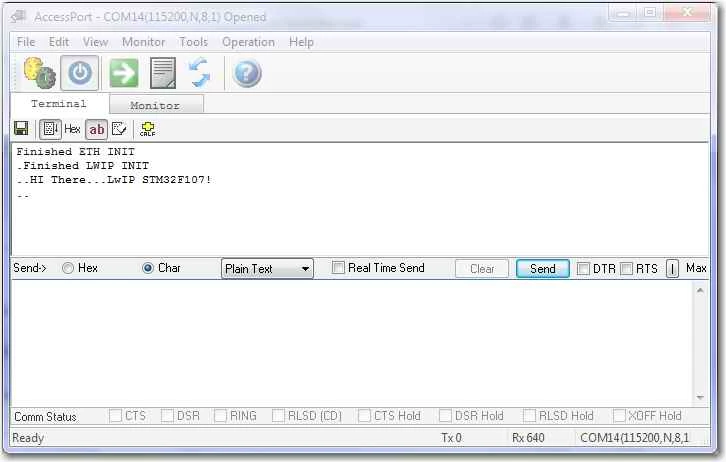

I'm using DP83848. , I have connected :
16    PC1    ETH_MDC
24    PA1    ETH_REF_CLK
25    PA2    ETH_MDIO
32    PA7    ETH_CRS_DV
33    PC4    ETH_RXD0
34    PC5    ETH_RXD1
48    PB11    ETH_TX_EN
51    PB12    ETH_TXD0
52    PB13    ETH_TXD1
But I tried to ping it and no response, on PHY module and computer are blinking, Green and orange LED...
Anything  I missed here ? thanks

Yes, the board I build myself,
and it's working on LED test for every ports needed for Ethernet, so the chip can send signal properly... and I tested with UART it's doing ETH init properly as well Here's the code, I use DP83848 PHY and STM32CubeMx to generate this code:

in lwip.c, I set IP address to 0.0.11, gateway 0.0.1 and mask 0....my computer, I set the same only the IP address is 0.0..
Any ideas Clive ? thanks

Here's the debug I get from UART....
