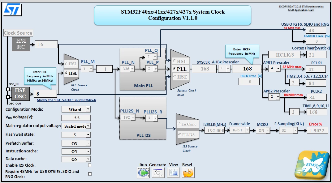

Hello community,

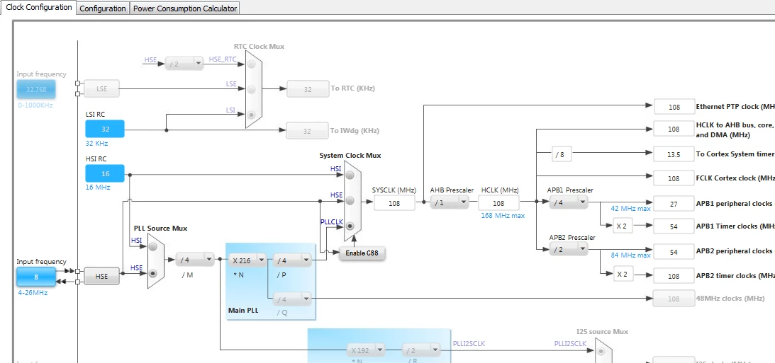

I getting my hands on STM32cubeMX tool for first time to generate project for STM32F405RG. The board has 8MHz oscillator connected to  OSC_IN, OSC_OUT pins. I was trying to configure the board to run at 168MHz, but I was only able to configure max 108MHz.
However I was able to configure 168MHz using the other clock configuration tool:
http://www.st.com/web/en/catalog/tools/PF257927
How could I be able to clock the MCU to 168MHz ?
Pls find the attached files ( STM32cubeMX project file, MS EXCEL clock config tool screenshot).
#clock #stm32f4cube

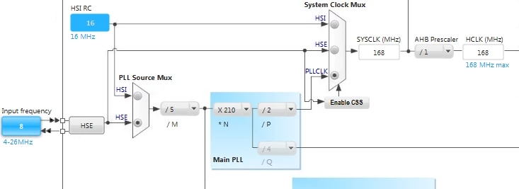

Please use the configuration below (PLL M : 5, PLLN : 210, PLL P : 2)
