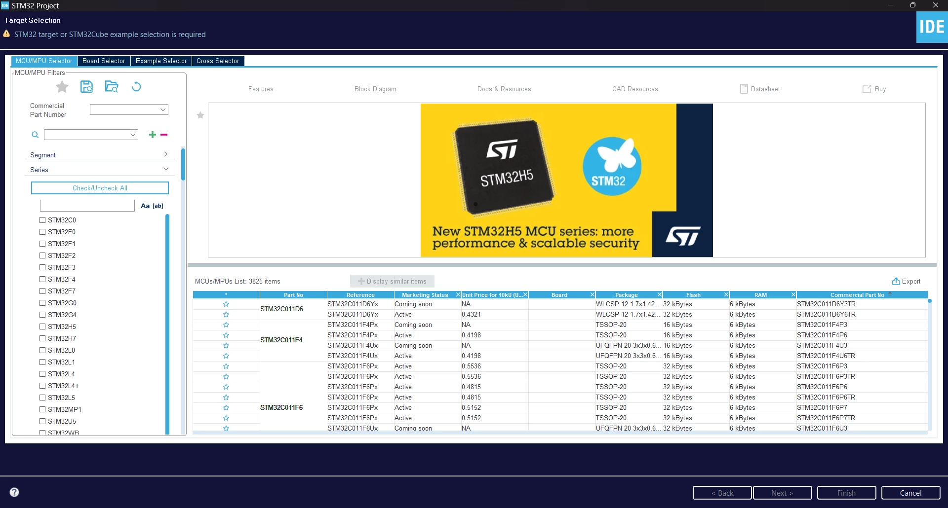

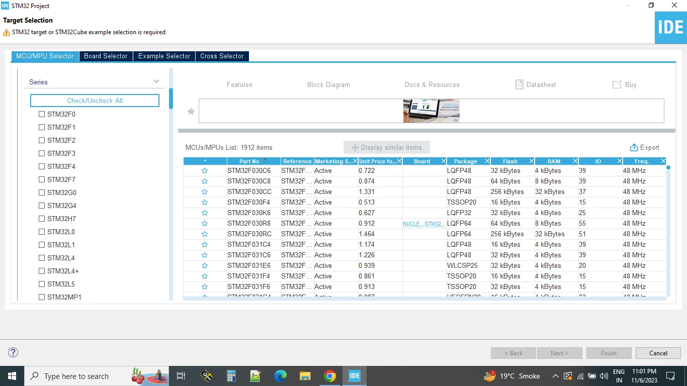

STM32CubeIDE not showing stm32c0 series - when starting new project (screenshot attached).
When I am trying to create a new project for STM32C011 series microcontroller, STM32 cube IDE not showing it in microcontroller selection list.
Do i need to install support/package for STM32C0 series, to create workspace for the STM32C0 workspace.

Nov 6, 2023 10:01 PM UTC
Please update CubeIDE or CubeMX to a recent version.

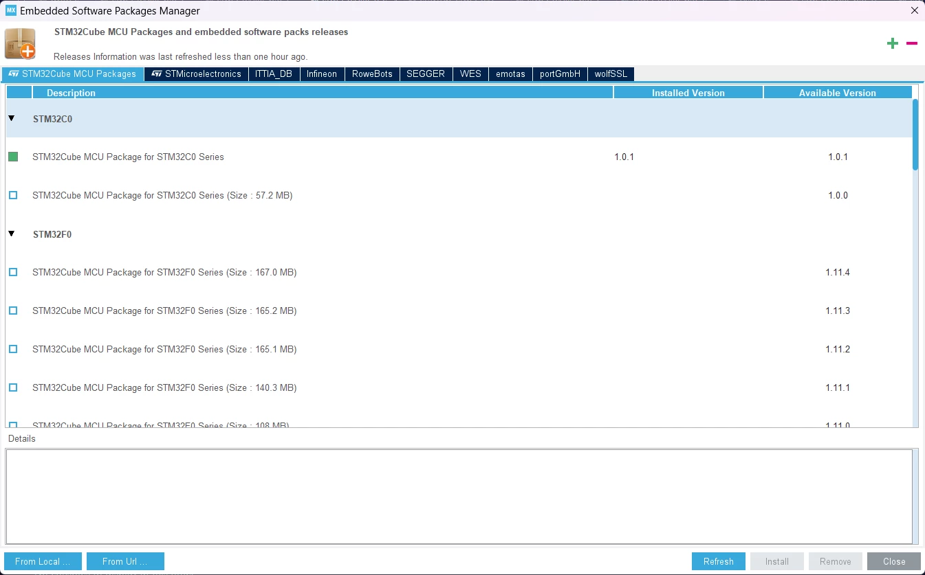

Nov 6, 2023 8:50 PM UTC
That's strange, for me it's the first one listed. Maybe your network is blocking something when CubeIDE is updating the devices list.
As for the need to install a support package, it's not really necessary at this stage of project creation. I don't have any support for F0 family and it is properly listed on the MCU selection screen.

Nov 7, 2023 8:21 AM UTC
Uninstalled old version and installed : en.st-stm32cubeide_1.13.2_18220_20230914_1601_x86_64.exe.
Its working now. Thanks for the support.
