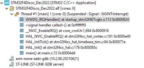

[STM32CUBEIDE] 1.11.0 Using STM32F407VGT6 fails to generate TIM6_DAC_IRQHandler
This initially an azrtos tx toggle LED test on a STM32F4Discovery board
I followed this video
MOOC - Azure RTOS workshop - 5 ThreadX lab - step1 - First thread creation - YouTube
The attached fileSTM32F4DISCO-1.10.1 works when compile with 1.10.1
After further debug with 1.11.0 it turns outs the attached STM32F4Disco-Dec2022 file crashes in HAL_INIT() because TIM6_DAC_IRQHandler() isn't generated in stm32f4xx_it.c.

Alec Davis 2021
Dec 16, 2022 9:02 AM UTC
In response to the debugging and localize where it stopped, I included the image it failed just after _NVIC_IRQ_ENABLE, which through a few levels of calling was called from HAL_INIT().
Tonight I just download the project STM32F4Disco-Dec2022.zip that I uploaded as a reference, which doesn't have "RTOS threadx" enable yet, imported it into STM32CUBEIDE, Regenereated the code and it still doesn't have TIM6_DAC_IRQHandler() in stm32f4xx_it.c and still crashes.
Enabled "RTOS threadx" and regenerate code
Still no TIM6_DAC_IRQHandler() in stm32f4xx_it.c and crashes in _NVIC_IRQ_ENABLE, as per image.
Removed the software pack X-CUBE-AZRTOS-F4, regenerated.
I don't know how I got this super simple project in this state, as every time I try to reproduce in a new project it will work as expected.
Then on another Windows PC, imported same project STM32F4Disco-Dec2022.zip that I imported into CUBEIDE 1.11.0, regenerated code, and stm32f4xx_it.c now has TIM6_DAC_IRQHandler() . ?????

Alec Davis 2021AuthorBest answer
Dec 18, 2022 9:58 PM UTC
Rebooted my original development machine, and now it generates IRQ_HANLDER as expected.
