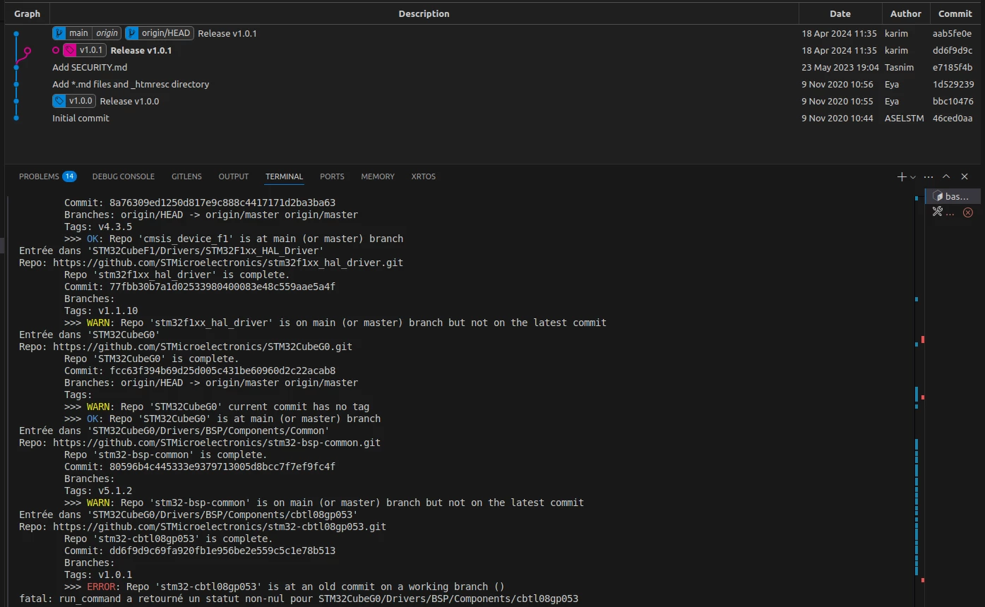

STM32CubeG0 git repository points to temporary branch in submodules
STM32CubeG0 git repository points to temporary branch in submodules.
Here the repository cbtl08gp053 is on tag v1.0.1 which is not part of main branch.
RAJMAIBest answer

Hello @hnvseau12,
First Thanks for your contribution, you are absolutely right. The repository cbtl08gp053 is on tag v1.0.1, which is not part of the main branch. I speak with GitHub team, and we will fix it soon. Thank you once again for your contribution and for raising this issue.

Hello @hnvseau12,
The issue has been successfully resolved, you can consult now: STM32CubeG0

Mar 9, 2025 6:49 PM UTC
I just published the script that allowed to find the issue, you may use it if that's of any help
https://gitlab.com/hnvseau/gitflow-checker
