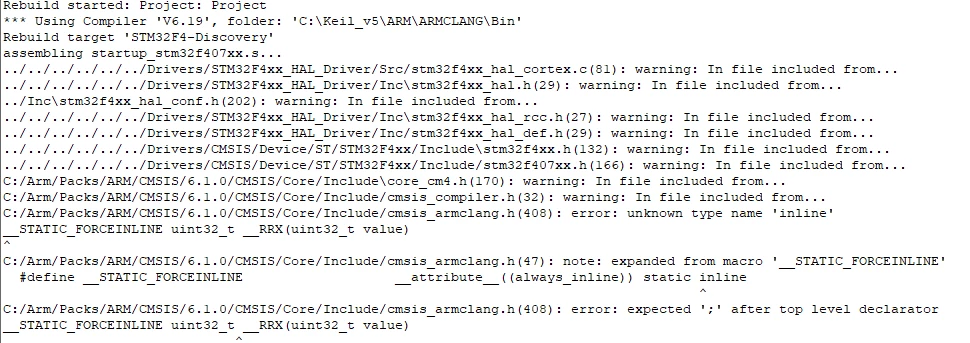

These steps that you mentioned I have already done them, when I figure out that the compiler used now is ArmClang but still I end up with the following error message for each single file compiled :
This just the build of simple example on the target STM32F4-Discovery, maybe I miss something

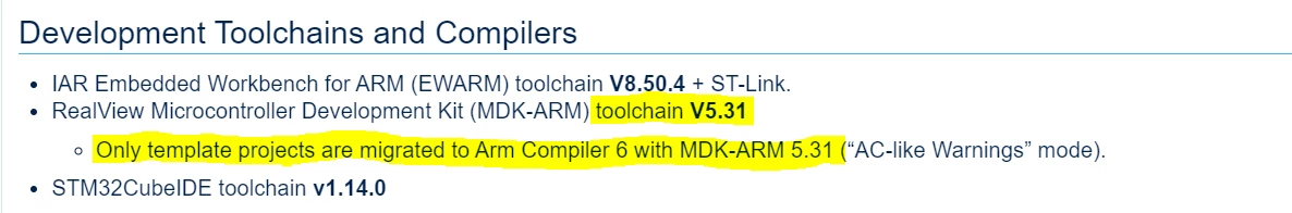

Hello @Bassem and welcome to the Community :),
The development toolchains and compilers for STM32CubeF4 1.28.0 are IAR V8.50.4, MDK-ARM V5.31 and STM32CubeIDE v1.14.0 as mentioned in release notes.
MDK-ARM 5.38 comes by default with AC6 only. To use it with AC5 compiler, please follow the steps available in this AN: https://developer.arm.com/documentation/ka005073/latest/"

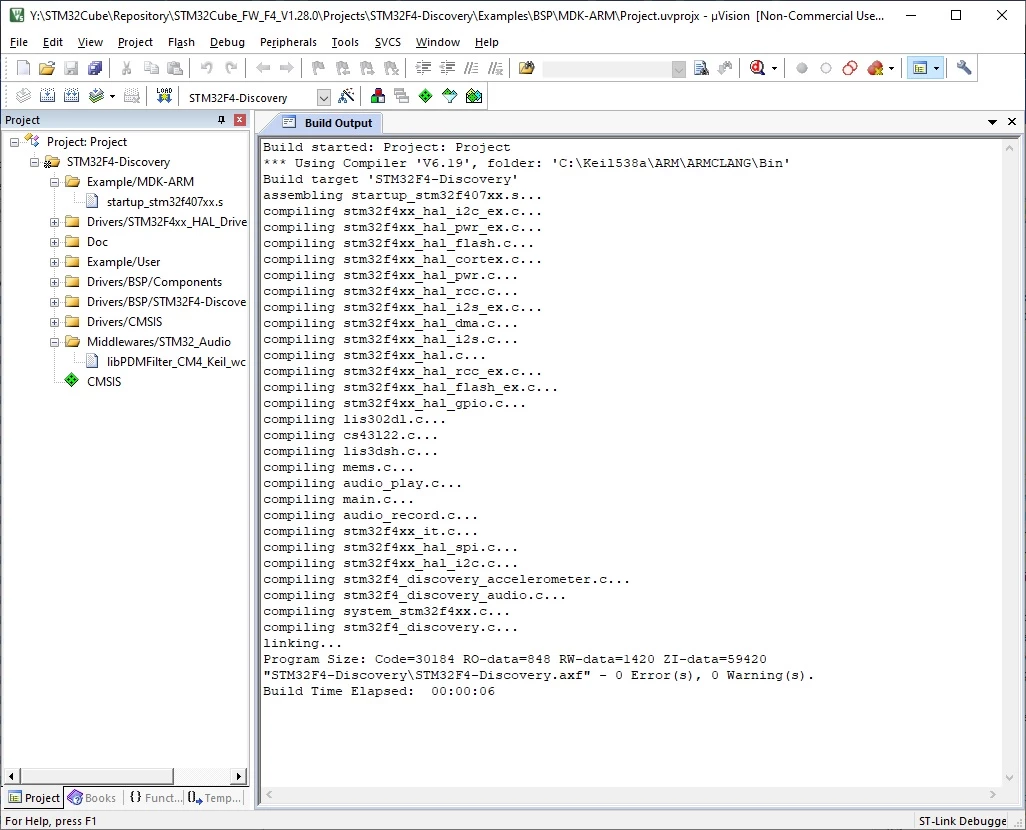

Tesla DeLorean
Guru
Jun 19, 2024 7:28 PM UTC
Looks to be because of a divergent version of CMSIS, would suggest the project contemporary version from the HAL directories. Let it pull F4 pack, selected Default V6, checkboxed C99
