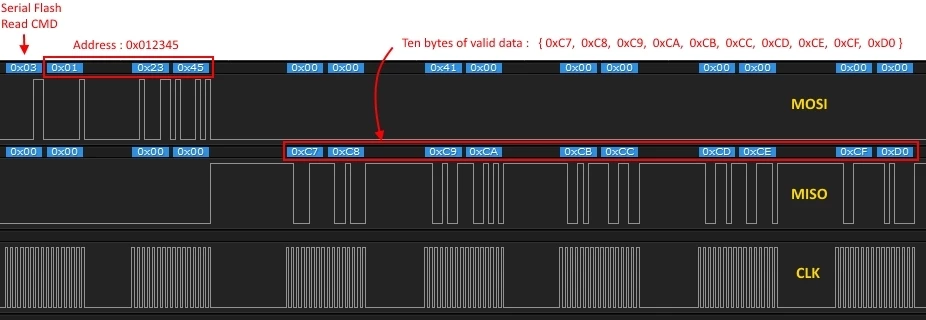

Hi All,
We are using STM32F072B and faced with SPI comm. problem.
I have seen that Cube SPI functions have some bugs. HAL_SPI_Receive does not reading first three byte and loosing last three byte. I have seen several bug reports about Cube SPI functions but could not find a similar one. Also tried HAL_SPI_TransmitReceive function and stiation is the same. Logic analyzer shows that valid data avaliable on bus but code does not read it.
Error is related with total number of byte transactions. For eg. it is OK for 1 byte TX and three byte RX. But not for 4 bytes of TX and 1 byte of RX.
Is there any workarounds or bug fix ?
Regards.

I am using CubeMX for initialization codes. And scope (logic analyser) view seem as expected. I can also read external Flash JEDEC ID accurately. But sometimes it returns 00 or FF for single byte read operation.

hspi1.Init.DataSize = SPI_DATASIZE_8BIT;
Are you sure the data size is 8 bit and not 16? I mean, look at your logic analyzer's output.

Yes, sure.
I have checked several frames from the logic analyser.
Electrical data is correct every time but code does not read it correctly.
I can see the appropriate data on bus but HAL does not return correct datas.

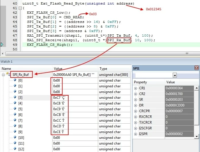

yilmazkircicek
August 15, 2016
Posted on August 15, 2016 at 15:27
Today I am strugling to write only single byte of data. (0x59) And reading it back.
All analyser data seems OK.
But it returns 00 when I tried to read even with the correct data on bus.
Then I tried to read 5 bytes from the same addres result is;
0x00 0x59 0x00 0x59 0xXX
Weird but true
I am using HAL functions.

yilmazkircicek
August 15, 2016
Posted on August 15, 2016 at 15:31
But these are not
uint8_t Ext_Flash_Read_Byte(unsigned int address)
EXT_FLASH_CS_Low();
SPI_Tx_Buf[0] = CMD_READ;
SPI_Tx_Buf[1] = ((address >> 16) & 0xFF);
SPI_Tx_Buf[2] = ((address >> 8) & 0xFF);
SPI_Tx_Buf[3] = (address & 0xFF);
HAL_SPI_Transmit(&hspi1, (uint8_t*)SPI_Tx_Buf, 4, 100);
HAL_SPI_Receive(&hspi1, (uint8_t*)SPI_Rx_Buf, 1, 100);
EXT_FLASH_CS_High();
return SPI_Rx_Buf[0];

> Yes, sure.
But.. look at the picture, every single transmission consists of 16 CLKs/bits.
