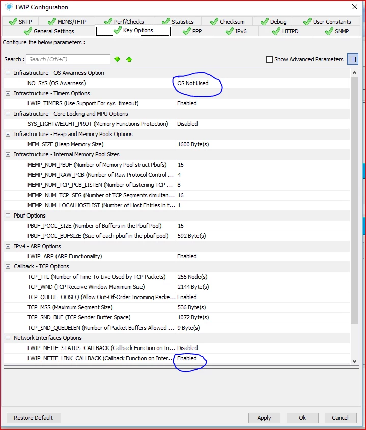

Hello everybody,
i have found a bug in STM32Cube V4.21.0.
I use the STM32F429BITx
When i select the following settings the generated code have some RTOS functions.
Please fix it.
void MX_LWIP_Init(void)
/* IP addresses initialization */
IP_ADDRESS[0] = 192;
IP_ADDRESS[1] = 168;
IP_ADDRESS[2] = 11;
IP_ADDRESS[3] = 181;
NETMASK_ADDRESS[0] = 255;
NETMASK_ADDRESS[1] = 255;
NETMASK_ADDRESS[2] = 255;
NETMASK_ADDRESS[3] = 0;
GATEWAY_ADDRESS[0] = 192;
GATEWAY_ADDRESS[1] = 168;
GATEWAY_ADDRESS[2] = 11;
GATEWAY_ADDRESS[3] = 1;
/* Initilialize the LwIP stack without RTOS */
lwip_init();
/* IP addresses initialization without DHCP (IPv4) */
IP4_ADDR(&ipaddr, IP_ADDRESS[0], IP_ADDRESS[1], IP_ADDRESS[2], IP_ADDRESS[3]);
IP4_ADDR(&netmask, NETMASK_ADDRESS[0], NETMASK_ADDRESS[1] , NETMASK_ADDRESS[2], NETMASK_ADDRESS[3]);
IP4_ADDR(&gw, GATEWAY_ADDRESS[0], GATEWAY_ADDRESS[1], GATEWAY_ADDRESS[2], GATEWAY_ADDRESS[3]);
/* add the network interface (IPv4/IPv6) without RTOS */
netif_add(&gnetif, &ipaddr, &netmask, &gw, NULL, &ethernetif_init, &ethernet_input);
/* Registers the default network interface */
netif_set_default(&gnetif);
if (netif_is_link_up(&gnetif))
/* When the netif is fully configured this function must be called */
netif_set_up(&gnetif);
else
/* When the netif link is down this function must be called */
netif_set_down(&gnetif);
/* Set the link callback function, this function is called on change of link status*/
netif_set_link_callback(&gnetif, ethernetif_update_config);
/* create a binary semaphore used for informing ethernetif of frame reception */
osSemaphoreDef(Netif_SEM);
Netif_LinkSemaphore = osSemaphoreCreate(osSemaphore(Netif_SEM) , 1 );
link_arg.netif = &gnetif;
link_arg.semaphore = Netif_LinkSemaphore;
/* Create the Ethernet link handler thread */
osThreadDef(LinkThr, ethernetif_set_link, osPriorityNormal, 0, configMINIMAL_STACK_SIZE * 2);
osThreadCreate (osThread(LinkThr), &link_arg);
/* USER CODE BEGIN 3 */
/* USER CODE END 3 */
#stm32cube-bug #bug #cube

Posted on July 04, 2017 at 11:24
You are right and this bug will be fixed in next STM32Cube V4.22.0 release.
Bino
July 4, 2017
Posted on July 04, 2017 at 11:44
The solution for you is to directly patch the following ftl file:
C:\Program Files\STMicroelectronics\STM32Cube\STM32CubeMX\db\templates\lwip_c_f2f4f7h7.ftl
Line 548: replace [#if series != 'stm32h7'] by
[#if (series != 'stm32h7') && (with_rtos == 1)]
Then generate again the code and it will be ok.
