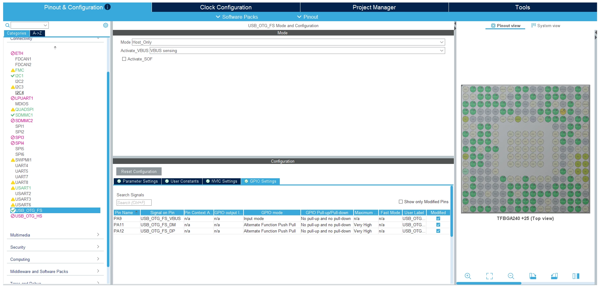

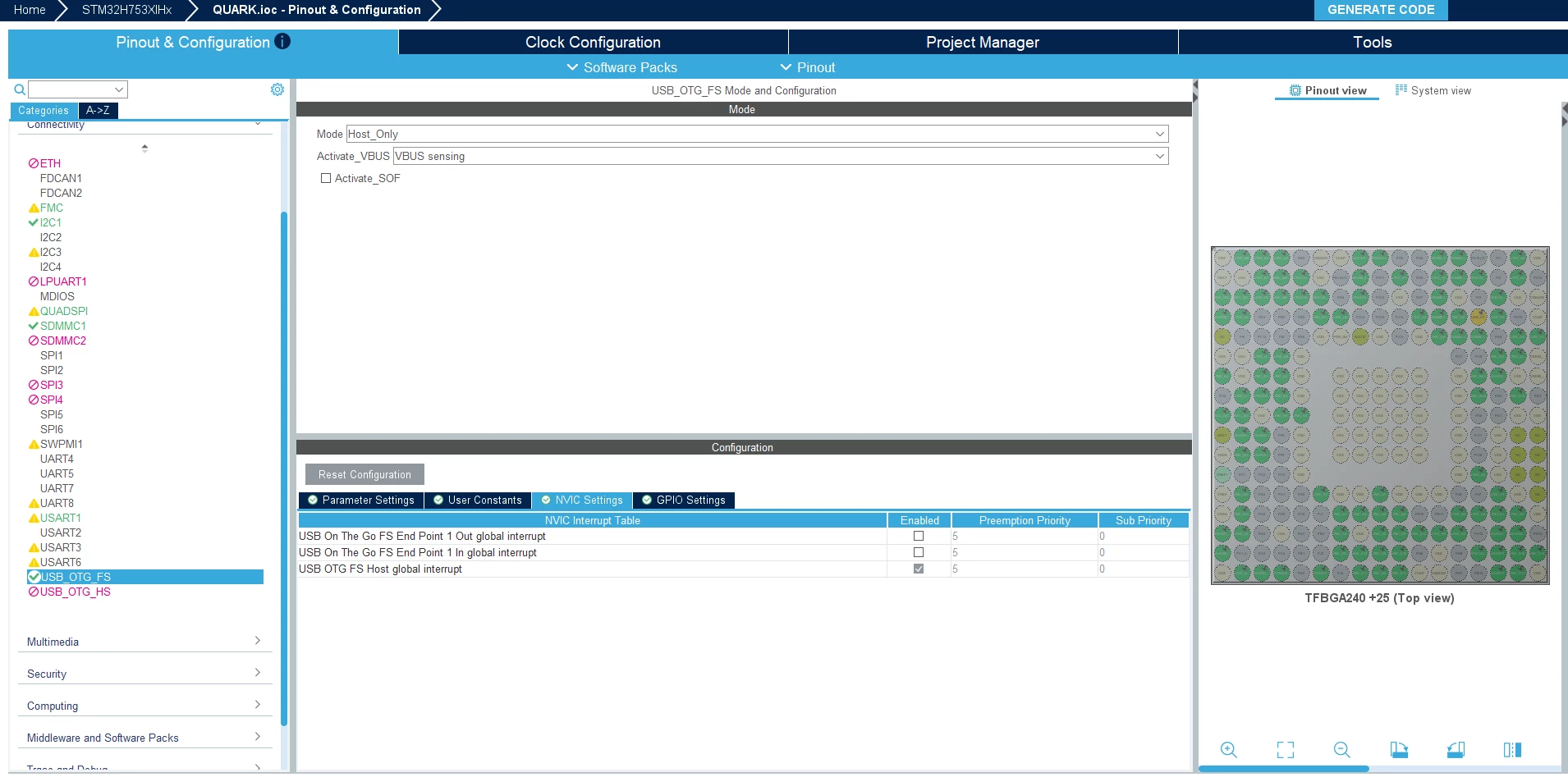

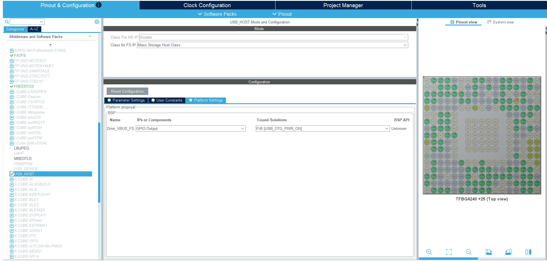

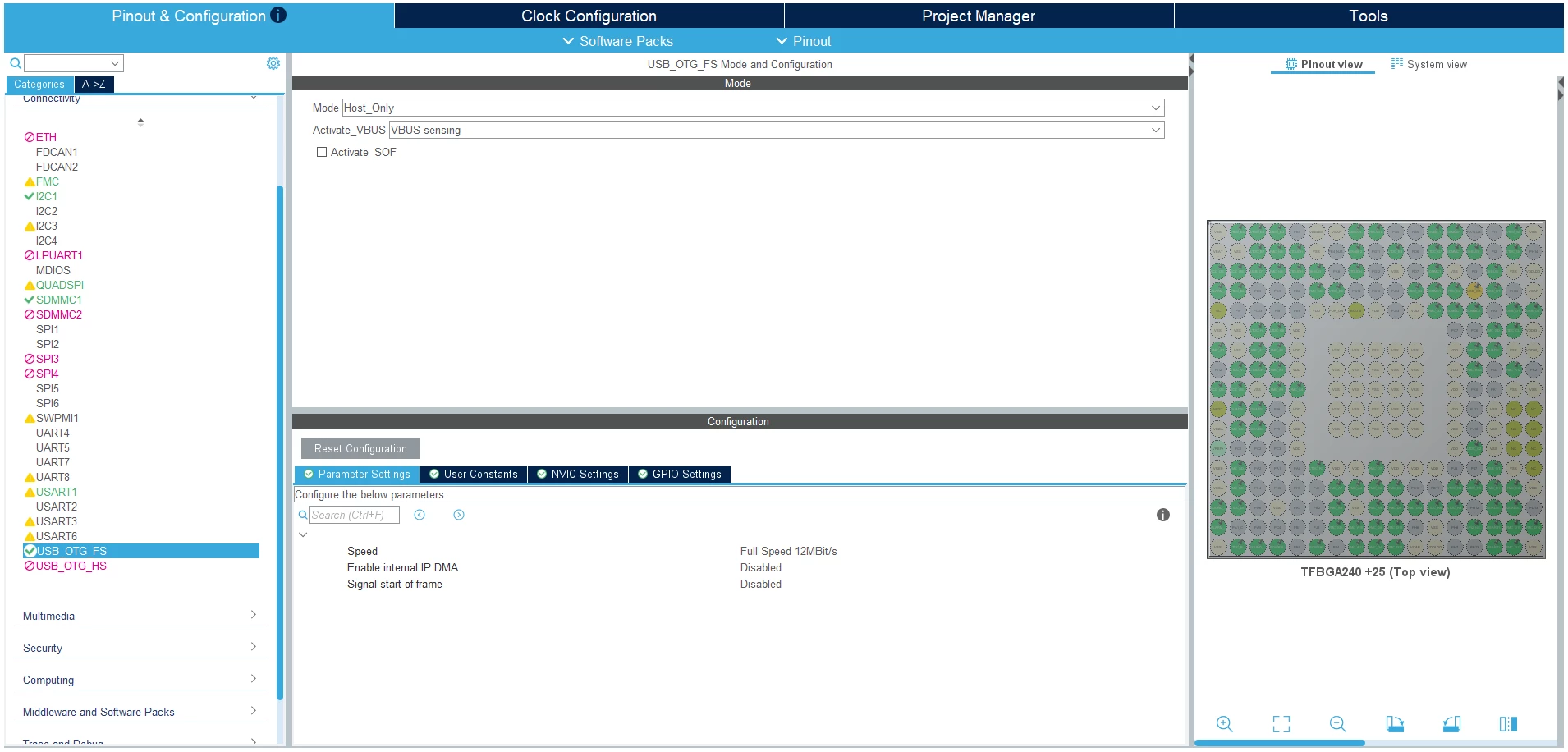

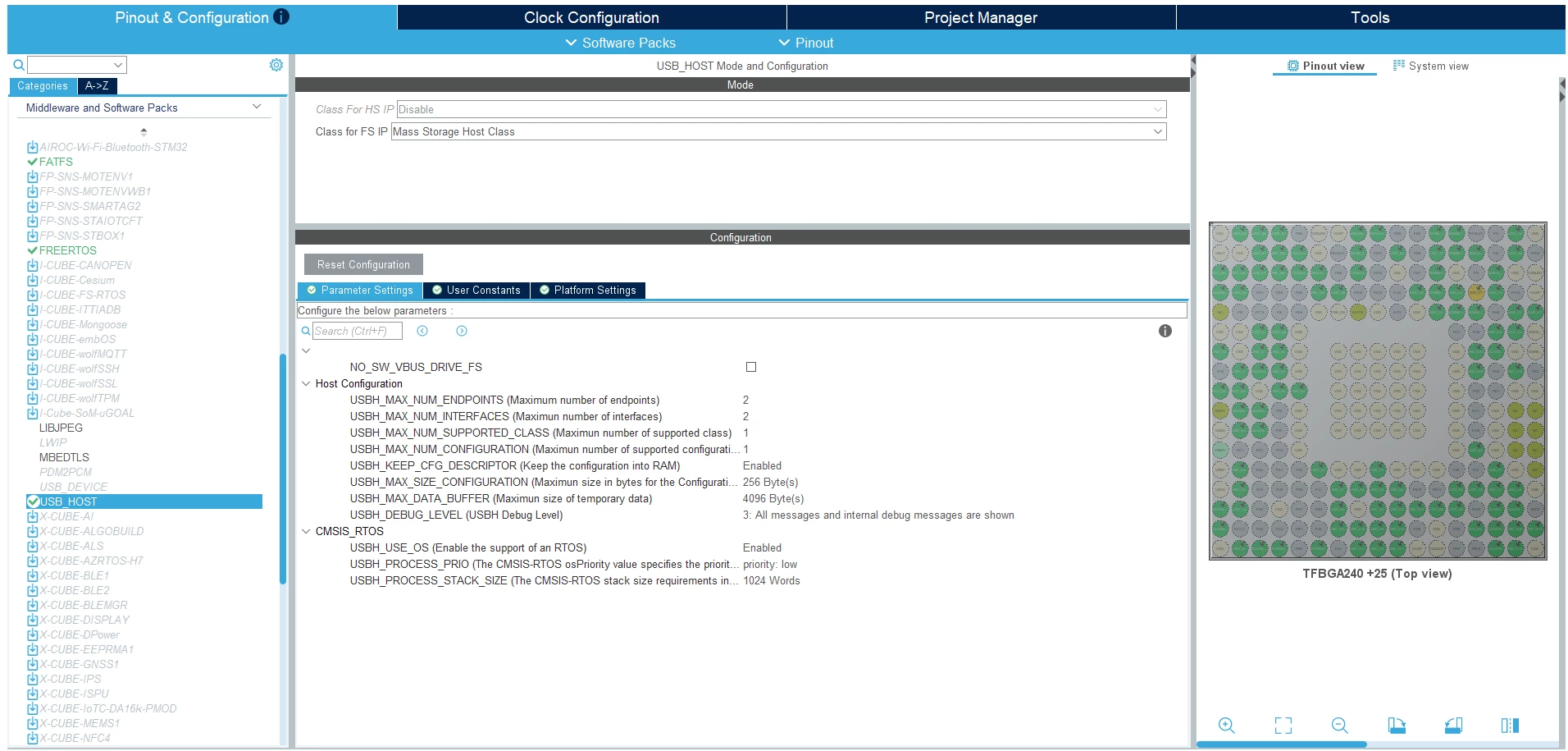

My MCU is STM32H753 on custom PCB. It is running at 480 Mhz.
I use USB USB_OTG_FS it is clocked by RC48.
On “Middleware and Software packs” I have enabled “FATFS”, “FREERTOS” and “USB_HOST”
I generated project by using CubeMX 6.17 with “STM32Cube_FW_H7_V1.13.0”.
For more details see attached pictures with configurations.

USB OTG FS pins
USB OTG FS parameters
USB OTG FS NVIC Settings
USB HOST Parameters settings
USB HOST platform settings

Also, STM32 embedded USB DMA is not the main lever for reducing CPU load here; that feature is generally relevant to USB_OTG_HS rather than FS. When internal USB DMA is available, it does not eliminate all CPU involvement. The USB stack and class layer still require software processing.

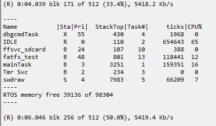

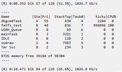

I just ran tests again. For my custom FatFS test thread “fatfs_test“ I set priority to osPriorityRealtime and observed interesting picture:
Pic.1 USB test. Thread “fatfs_test“ with priority osPriorityRealtime
What you can see, is that all other threads not getting any CPU ticks (except the one used for debug UART commands processing). The “fatfs_test” thread is taking all of the CPU time it can get. That looks like all that time is waisted somewhere inside “USBH_MSC_Write” and “USBH_MSC_Read” in loop:
  while (USBH_MSC_RdWrProcess(phost, lun) == USBH_BUSY)
if (((phost->Timer - timeout) > (10000U * length)) || (phost->device.PortEnabled == 0U))
return USBH_FAIL;
It feels like while data transfer is in progress whole thing is just polling USB host controller non-stop, instead of self lock until transfer complete (or error occurs), like it implemented for SD-card. But again, I have zero clue how USB host controller works in STM32. Maybe as is - is the way to go.
See, this is not happening when I run SD-card test:
Pic.2 SD-card test. Thread “fatfs_test“ with priority osPriorityRealtime
Both tests (USB and SD-card) are done by same thread “fatfs_test“, it just get different path pointing to different drives.
