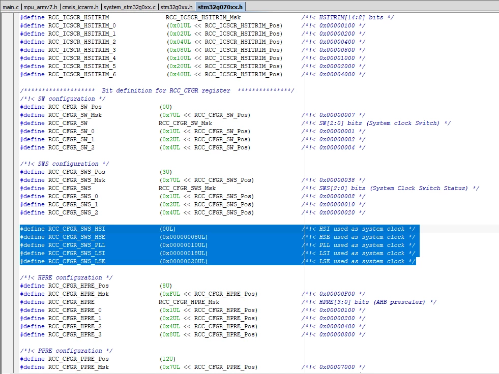

STM32Cube_FW_G0_V1.4.0 bug ?
I work with STM32G070RBT. I upgrade FW to STM32Cube_FW_G0_V1.4.0.
These definitions have disappeared from the file stm32g070xx.h:
#define RCC_CFGR_SWS_HSI              (0UL)                                  /*!< HSI used as system clock */
#define RCC_CFGR_SWS_HSE              (0x00000008UL)                         /*!< HSE used as system clock */
#define RCC_CFGR_SWS_PLL              (0x00000010UL)                         /*!< PLL used as system clock */
#define RCC_CFGR_SWS_LSI              (0x00000018UL)                         /*!< LSI used as system clock */
#define RCC_CFGR_SWS_LSE              (0x00000020UL)                         /*!< LSE used as system clock */
My project cannot bild at this time.

Peko
PekoAuthor
November 20, 2020
The problem has occurred at migrate project (created with STM32Cube_FW_G0_V1.3.0) to STM32Cube_FW_G0_V1.4.0 in STM32Cube IDE V1.5.
All necessary files have been upgraded, only file system_stm32g0xx.c in my project remained unchanged.
In this file is function void SystemCoreClockUpdate(void)
case RCC_CFGR_SWS_HSE: /* HSE used as system clock */ !!!! this definitions are missing in new stm32g070xx.h
SystemCoreClock = HSE_VALUE;
break;
case RCC_CFGR_SWS_LSI: /* LSI used as system clock */ !!!! this definitions are missing in new stm32g070xx.h
SystemCoreClock = LSI_VALUE;
break;
case RCC_CFGR_SWS_LSE: /* LSE used as system clock */ !!!! this definitions are missing in new stm32g070xx.h
SystemCoreClock = LSE_VALUE;
break;
case RCC_CFGR_SWS_PLL: /* PLL used as system clock */ !!!! this definitions are missing in new stm32g070xx.h
!!! The „migrate program“ should overwrite the function void SystemCoreClockUpdate(void) !!!
switch (RCC->CFGR & RCC_CFGR_SWS)
case RCC_CFGR_SWS_0: /* HSE used as system clock */
break;
case (RCC_CFGR_SWS_1 | RCC_CFGR_SWS_0): /* LSI used as system clock */
break;
case RCC_CFGR_SWS_2: /* LSE used as system clock */
break;
case RCC_CFGR_SWS_1: /* PLL used as system clock */
I rewrote the stm32g0xx.c file in my project with the new file stm32g0xx.c from Repository STM32Cube_FW_G0_V1.4.0 and now everything is fine.

Steven1
December 4, 2020
Deleting the system_stm32g0xx.c file and regenerating code will generate the correct file. This seems to be a quick solution for now.

Visitor II
July 17, 2023
I encountered the same error when switching from stm32g0-hal-1-3-0 to stm32g0-hal-1-4-0. I looked for the definitions that were missing and generating compilation errors in stm32g0-hal-1-4-0 in the old stm32g0-hal-1-3-0 version. I found that in the file stm32g070xx.h from stm32g0-hal-1-4-0 the following definitions are missing:
I copied the definitions from the stm32g070xx.h file from the STM32Cube_FW_G0_V1.3.0 firmware version into the stm32g070xx.h file from the STM32Cube_FW_G0_V1.4.0 firmware version and I managed to compile the project without errors.
