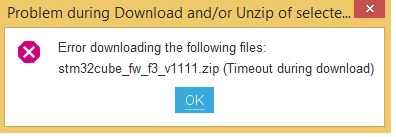

stm32cube_fw_f3_v1111.zip ''timeout during download'' - IDE unable to download package at 1st use

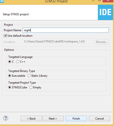

I have just installed the "STM32cude IDE'' and have a "nucleo F303 RE''.
I'm tryping to create a stm32 project "file -> new -> STM32''. But when initializing everything for the first time, the IDE start dowloading packages and ''stm32cube_fw_f3_v1111.zip'' is one of them. But it always to do so. I have tried many times but no success. I have made researches on the internet, but not much answers either. Some people say to download it manually but I can't find this package.
As you can see on the image, the workspace as been created in ''Guest/STM32CubeIDE/workspace/'' which I think is good.
What do you think is the problem? And what can I do to start creating my 1st project.

It's generally bad form to post a duplicate question, especially after only 8 hours.
https://community.st.com/s/question/0D53W00000Ny4XWSAZ/ide-cant-download-stm32cubefwf3v1111zip-error-dowloading
Could be an issue with your firewall/proxy blocking access. Could be STs site is down. You could try downloaded standalone STM32CubeMX and trying it there.

Hello @FMike.1​ ,
Welcome to the STM32 Community :smiling_face_with_smiling_eyes:.
I have successfully download and install this package from ST web and STM32CubeMX !
Maybe it was just a browser-cache issue, or slow server response. So, I suggest to clean your cache and try again.
However, to find a way out of that situation, I send you the needed package via drive: STM32CubeF3 V1.11.1

Hi Guys,
thanks for your help both of you.
The problem was the firewall proxy.
I couldn't download your file Imen just to tell you how it was.
But it's fixed now.
