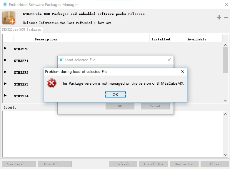

stm32Cube can not install stm32Cubef3 package from local.
The STM32Cube version is 4.24.0, and STM32Cubef3 package version is 1.9.0.
While I tried to install the package from local, error happens:
This Package versions is not managed on this version of STM32CubeMX.
How can I solve it?
Thx.

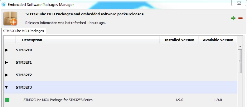

Posted on March 06, 2018 at 11:44
Hello
spica.lai
Didyoudownloadthe STM32Cubef3 from ST web site
http://www.st.com/content/st_com/en/products/embedded-software/mcus-embedded-software/stm32-embedded-software/stm32cube-mcu-packages/stm32cubef3.html
May be you cantry to install the package
automatically from
CubeMX by
Select Help > Manage embedded software packages.
Then let me informed about the result.

hi, Imen,
Yes, I download the package from st official site exactly from the link you gave me.
And I install the package from local, error happens:

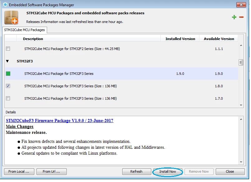

Posted on May 04, 2018 at 13:07
spica.lai
You're right, there is a problem in
installing
stm32Cubef3 package from local. It will be resolved next CubeMX release : 4.0. In the mean time you can install the
stm32Cubef3 package
a
utomatically from
CubeMX by
Select Help -> Manage embedded software packages ->Select STM32F3 1.9.0 for example -> select Install Now (not from local).
