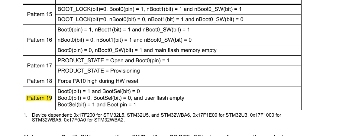

The STM32C552RET6 comes in an LQFP64 package. According to the AN6274, USART1 (PA9/PA10) and USART2 (PA2/PA3) and UART4 (PA0/PA1) are all available on this package.
3. BOOT configuration:
The STM32C55x bootloader is activated by applying Pattern19 (as referenced in AN2606 Table 2)
