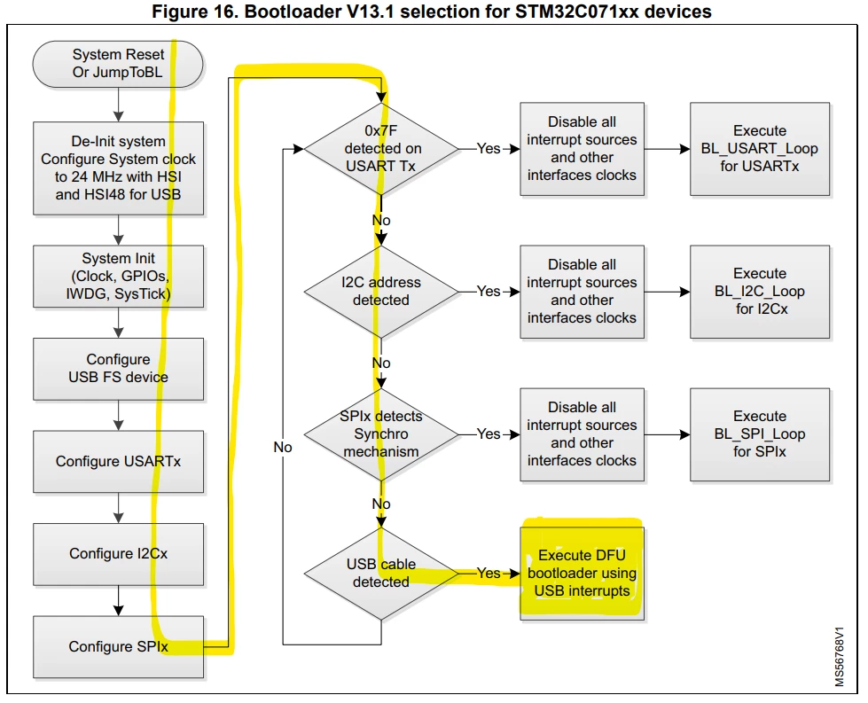

I agree with you that this failure looks related to interrupts or peripheral cleanup. What makes it even more interesting is that my bootloader does not initialize USB at all. I only use a jump to the STM32 embedded bootloader, which detects the USB connection and enters DFU mode:
