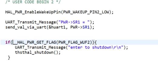

I'm trying to determine the source of the wakeup flag, whether it's the power being turned on or the trigger of wakeup pin 2.

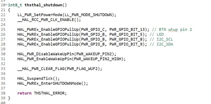

So this is my shutdown function:
After i changed my shutdown function :
when I try to determine the reason for the wakeup, the register `PWR->SR1` is always 0 when I turn the power on and when I trigger wakeup pin 2.
 Is the `PWR->SR1` register reset after waking up from shutdown mode ?
I tried something just for testing :
I enabled the wakeup pin in low polarity before checking the register. So, when I trigger the wakeup pin, the `PWR->SR1` is 0, and when I power on the device, it is 2. With this, I can determine the wakeup source, but I don't think it's a good solution :
Can you please give us some feedback about this issue ?

For me, the wakeup flag is always zero when I press the button (When the debug is disabled), whereas in debug mode, I receive pwr->SR1 = 258 when I press the button.
