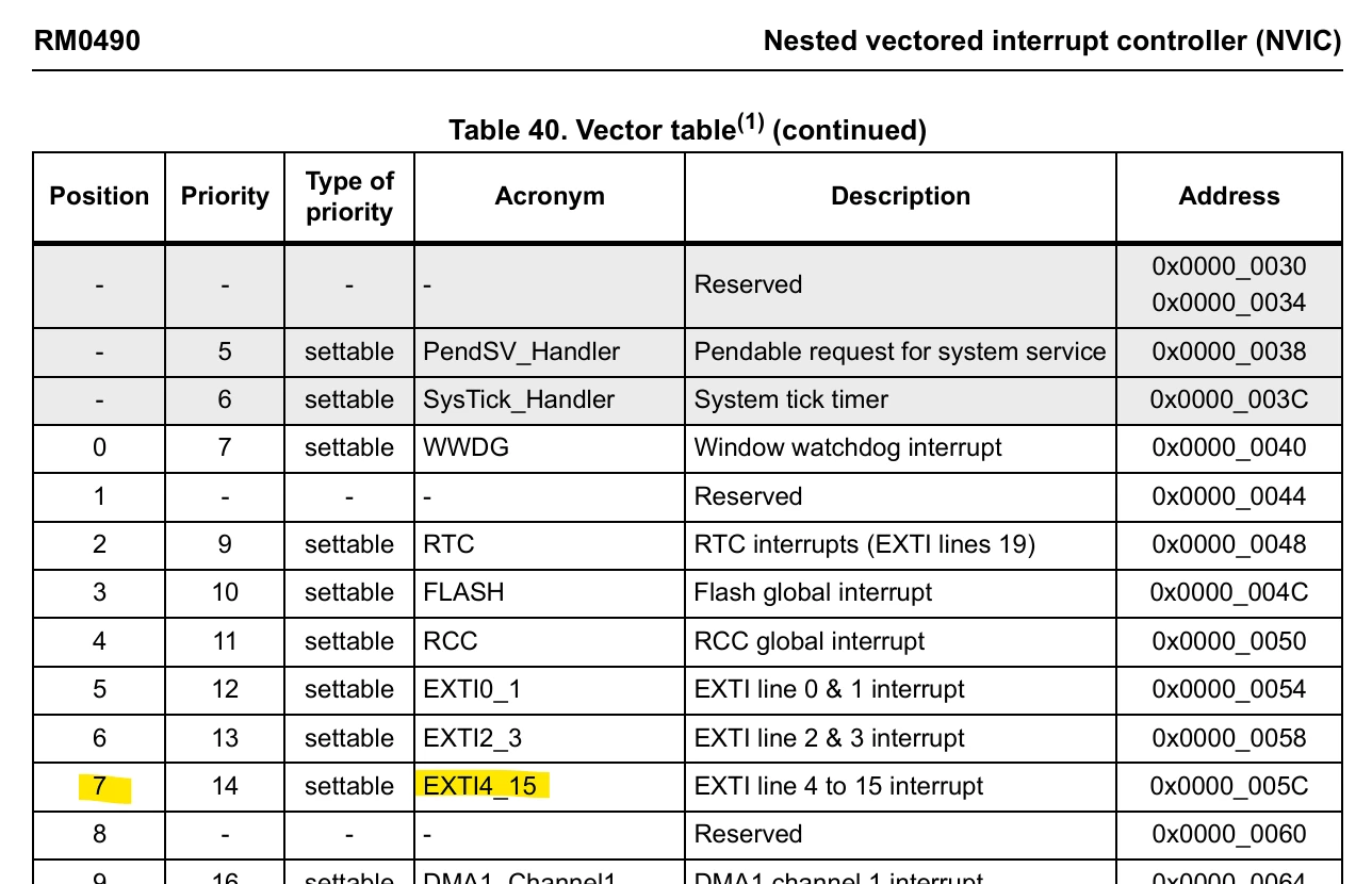

I'm a newbie working with STM32C031, setting up interrupt for user button (blue button) integrated on the board.
I am using VS Code, GNU_ARM_GCC, and CMSIS. No hal.
while setting up interrupts, interrupt priority, etc. , I am making use of CMSIS functions which use parameter IRQn_Type which defines interrupt numbers and defined interrupt number 4-15 as 7, which I do not understand.
Why 7?
How does shifting a "one" 7 to the left turn on interrupt 13, for example?

EXTI4_15_IRQn is interrupt 7. The ISER register has one bit per interrupt. Shifting "1" to the left by 7 places yields a 1 at the 7th bit and 0 everywhere else, which is the mask needed to enable EXTI4_15_IRQn.
The EXTI4_15_IRQn interrupt is common for pin numbers 4-15. They all come through on this same interrupt.

Aug 1, 2024 2:07 AM UTC
You can find the vector table in the reference manual.
The documentation for the ISER register will be in ARM documentation, since that's part of the core.
