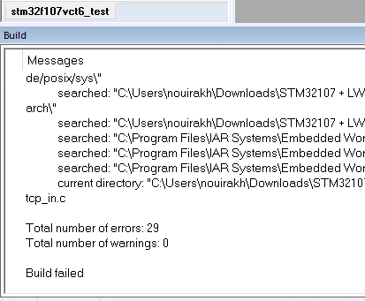

Hello @srdas
I have tested the project you have attached. I found this compilation error
"Fatal Error[Pe1696]: cannot open source file "reent.h"
Also, In the CubeMX configurations you need to replace this parameter "FREERTOS$context:USE_NEWLIB_REENTRANT" by 1, This configuration solves the problem.
Otherwise, To reproduce the issue and perform the necessary tests, I recreate a new project with the same configurations using the latest CubeMX version 6.11.0 and EWARM 9.30 and CubeIDE 1.14.0.
I have attached the ZIP file of the project(with FreeRTOS)
Could you check it with the same setup from your end?
