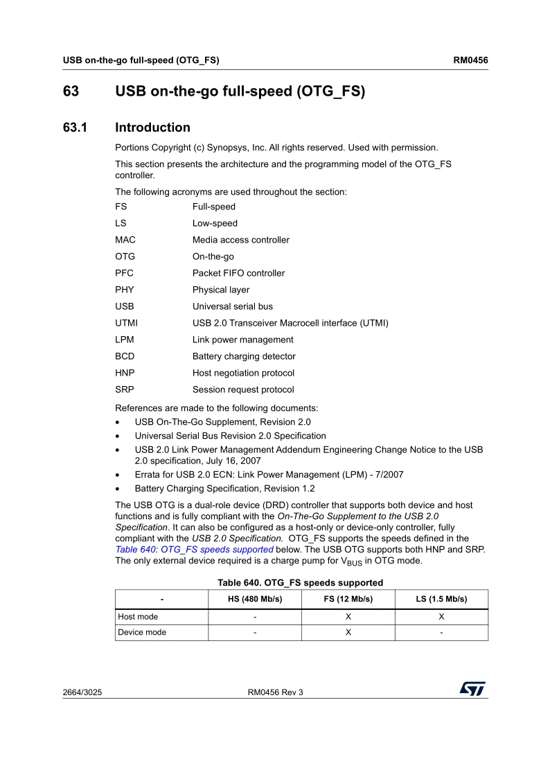

> Can you tell me if the STM32U5 series are also using the 'device-only' IP ?
No, it's the Synopsys OTG module.
0693W00000LxFuzQAF.png> If I've understood correctly, then with 4 endpoints (both IN and OUT), I can create 2 CDC-ACM interfaces
Yes, you need EP0, 2 pairs of In/Out endpoints and 2 In endpoints (not Out - note, that the definition in standard is such that In/Out is always from the point of view of the host, i.e. In for device is Tx, Out for device is Rx).
> What about the Isochronous endpoints ? Can I also use one "full" endpioint (IN and OUT parts) for data transfers (from host, and to host) ?
I dont' understand the question. "isochronous" is the property of the endpoint. As I've told you, inherently In and Out endpoints of the same number are entirely independent, it's only ST's device-only module which couples them due to inadequately designed hardware.
