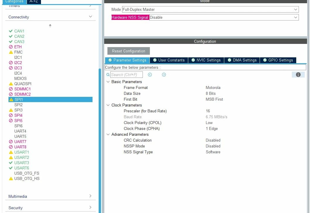

I am currently configuring SPI on the STM32F765ZGT board and using both blocking (polling) and interrupt-based methods for SPI transmission and reception. However, I am encountering an issue where the following condition evaluates to true, resulting in a HAL_BUSY error:
if (hspi->State != HAL_SPI_STATE_READY)
errorcode = HAL_BUSY;
goto error;
I would appreciate any insights on what might be causing this issue and potential solutions to resolve it.

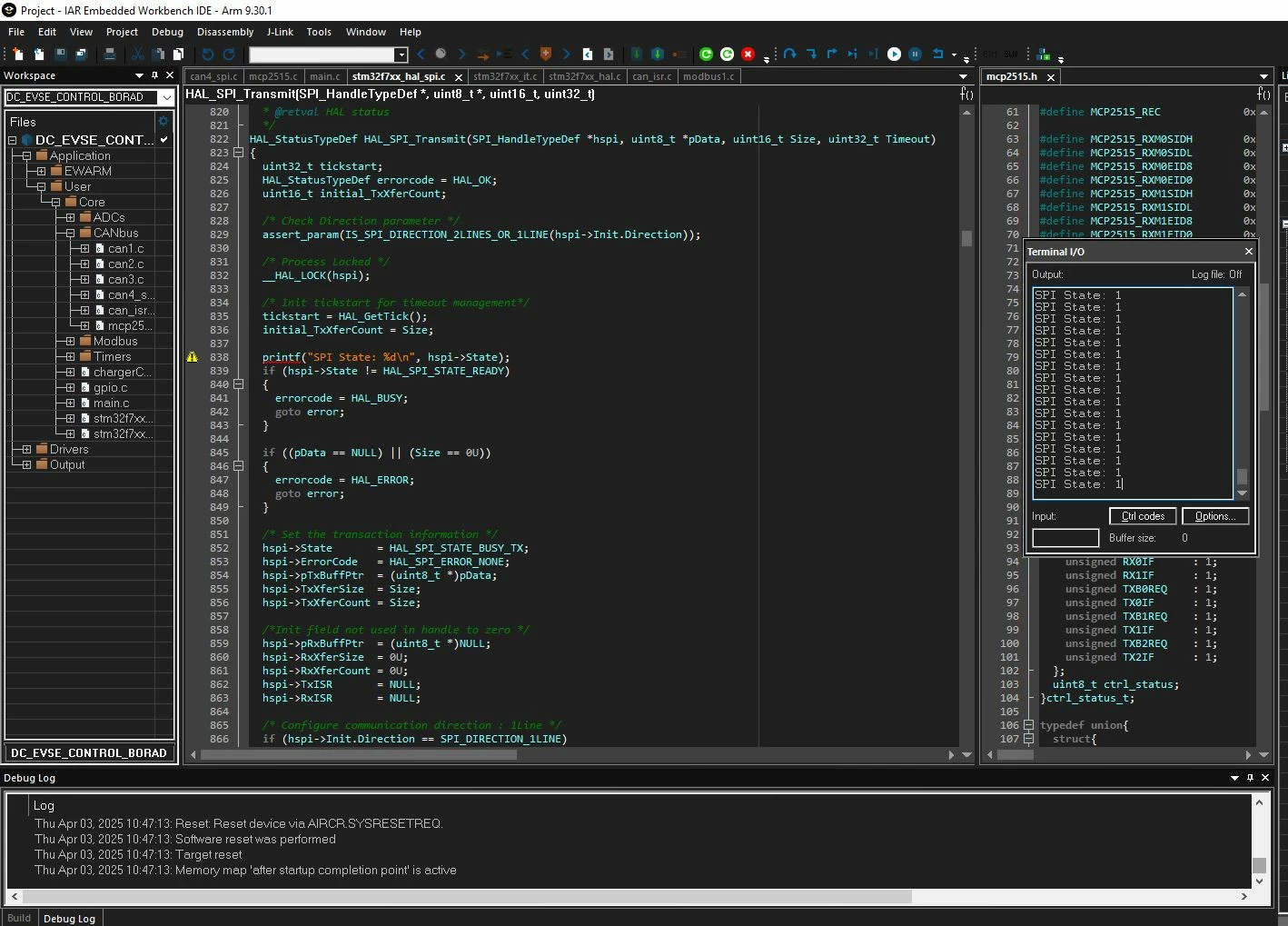

I am printing the state before this condition
printf("SPI State: %d\n", hspi->State);
goto error;
i am getting
SPI State: 1       (1 means already in ready state)

But what did you do before the call to HAL_SPI_Transmit?
Actually show ALL of your calls to ALL of the SPI transmit/receive functions, or at least all the ones up to the call you showed above.

Hello @anuj18ap
The issue arises because the SPI polling process is being called before the SPI interrupt process finishes.
To resolve this, you need to add a flag in the SPI transfer complete callback function. Then, check this flag in the main function before calling the polling process.
