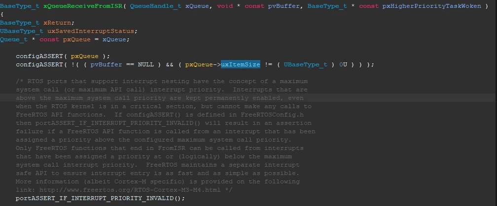

I have tried debugging en have found that he kinda gets stuck in queue.c on line 1794. But I don't understand how these are related.

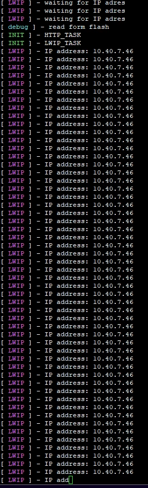

I have modified my linker so I can write to sector 11 (I use a the STM32F407 controller).
WilliamVR_1-1718106658676.pngtest print:
(it stops printing after this)
