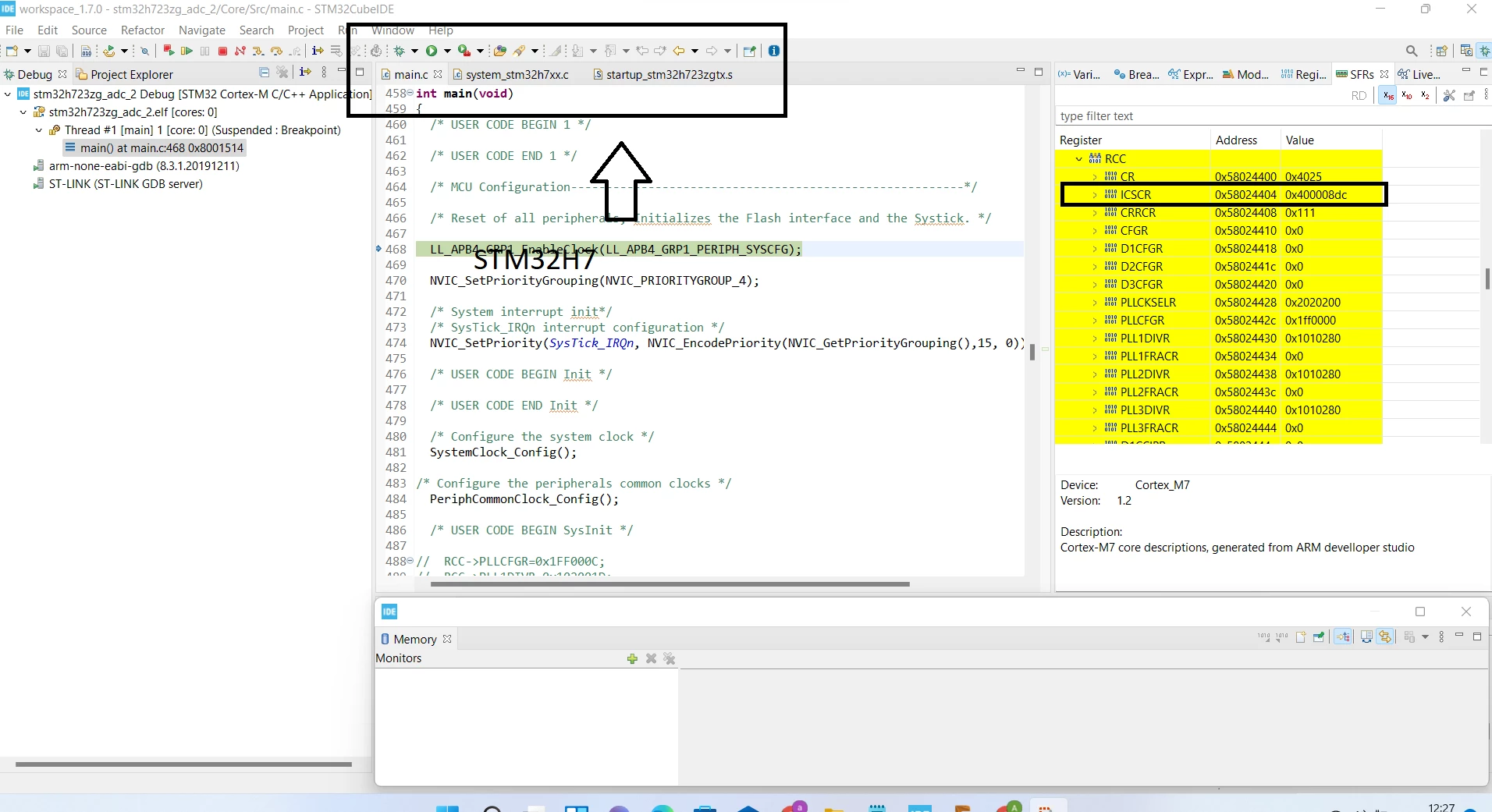

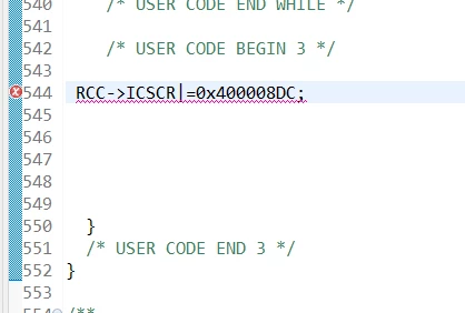

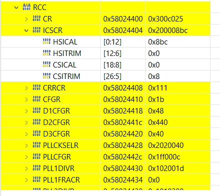

stm32 RCC Register ?
While looking at the rcc registers, you can see the ICSCR register on the debug screen, but when I write on the program, I encounter an error, I wonder what is the reason.0693W00000HnbiQQAR.png0693W00000HnbiLQAR.png

waclawek.jan
Dec 6, 2021 8:08 AM UTC
Which STM32, exactly?
Don't you try to set reserved bits?

Peter BENSCH
Dec 6, 2021 8:11 AM UTC
The RCC_ICSCR is not completely free for write access, see the reference manual of the respective derivative.
If you want to write the rw bits, you have to access them bytewise.

I don't see ICSCR in the RCC registers in RM0468.
Peter BENSCH
Dec 6, 2021 9:28 AM UTC
An ICSCR only exists in the STM32G0, STM32G4, STM32L0, STM32L4, STM32L5, STM32U5, STM32WB.
Are you sure you are debugging an STM32H723?

Peter BENSCHBest answer
Dec 6, 2021 10:34 AM UTC
Hmm, there still seems to be an incorrect designation in STM32CubeIDE: the register at 0x58024404 is correctly called RCC_HSICFGR according to RM0468, Section 8.7.3. It is also defined as HSICFGR in stm32h723xx.h.
Its bits [30:24] can e.g. be set with an access of this type:
RCC->HSICFGR |= (value << 24) // value: bit30...24, i.e. 0x00...0x7F
Please keep in mind, you should read out the bits beforehand and clear them (e.g. &), then modify the bits read out and write them back using the or (|) mentioned above.
