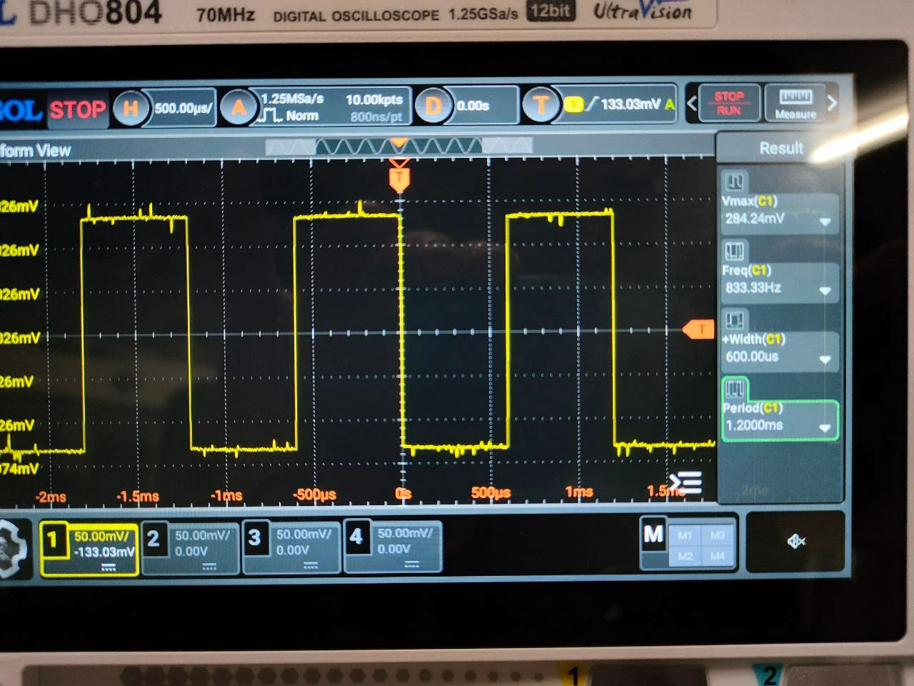

Problem:
I'm working with an STM32H743 and trying to generate a PWM signal (Center Aligned) on PE9 using Timer1 (TIM1). Although the PWM output is functioning, the frequency is not what I expect. I’m trying to generate a 1 kHz signal, but instead, I’m getting around 833 Hz, and I’ve confirmed that the period is incorrect.This is for driving a stepper motor.
What I have done so far:
  • Clock Configuration: The system clocks (HCLK, PCLK2, SYSCLK) are verified and appear to be configured correctly.
  • Timer Configuration: I'm using Timer1 in PWM Mode 1 with a prescaler of 199 and ARR of 999 to generate a 1 kHz PWM signal (expected 1 MHz timer clock). However, I’m getting an incorrect frequency (around 833 Hz).
  • GPIO Configuration: I’ve configured PE9 for TIM1 CH1 (PWM output).
     - My Code

  • What Happens:
    • Expected Output: A 1 kHz PWM signal with a 50% duty cycle on PE9.
    • Actual Output: The signal has an incorrect frequency of around 833 Hz (not 1 kHz as expected).

waclawek.jan
November 16, 2024
Your system clock is most likely not 400MHz, but 333.200MHz, most likely as consequence of a different primary clock source frequency than you've set (e.g. you assume 12MHz primary clock but it's in fact 10MHz).
HAL_RCC_GetHCLKFreq() etc. functions don't actually *measure* the HCLK/APB etc. frequencies; rather, they rely on a system variable (SystemCoreClock) being set properly in HAL_RCC_ClockConfig() by calling HAL_RCC_GetSysClockFreq(), which in turn uses one of HSI_VALUE/CSI_VALUE/HSE_VALUE set in stm32h7xx_hal_conf.h depeding on what primary clock source you've set.
November 21, 2024
Hello @sktech
Did you measure the clock frequency? If the measured value is different from the theoretical value, it could be the reason for this issue.
To measure the clock frequency, you can use an oscilloscope to monitor the output on the MCO pin.
