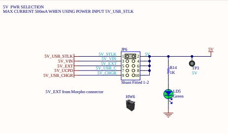

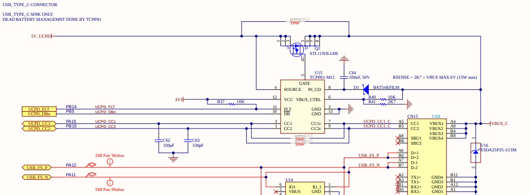

I have an ST Nucleo U5A5ZJ-Q board. I am powering the board through the CN1 connector and using the ST-LINK at the same time.
In the project I am working on, I would like to connect a USB device to the hardware. For this purpose, I want to use the USB Type-C connector.
When I connect the sensor to the Type-C connector, it does not receive any power. My assumption is that I cannot power the device through the USB Type-C connector. Also, LD7 does not light up.
I wanted to consult you about this before doing anything that might damage the board.

see board circuit:
https://www.st.com/resource/en/schematic_pack/mb1549-u5a5ziq-c04-schematic.pdf
5V_ucpd needs power:
you have to set jumpers: 1-2 , if st-link should give the power ; + 7-8 for 5V_ucpd
your software has to run the USB-host , to check a connected device;
MSC host for connecting an usb-stick, etc. for other devices
