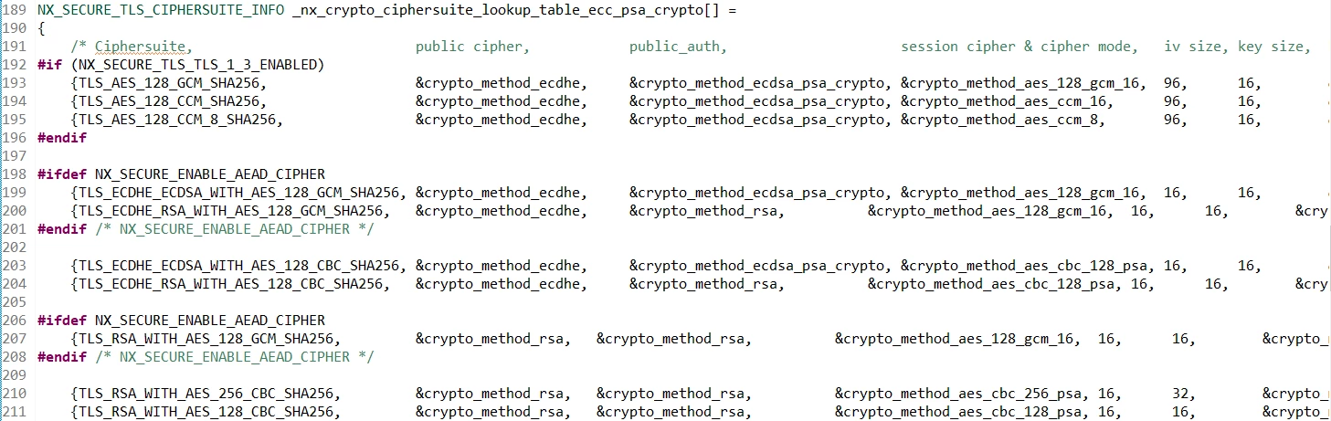

Is the issue here that there is no psa implementation for the GCM case?
By looking at the _nx_crypto_ciphersuite_lookup_table_ecc_psa_crypto[] table in nx_crypto_psa_crypto_ciphersuites.c it appears that all the GCM methods (e.g.crypto_method_aes_128_gcm_16)  listed are those from the "standard NetXDuo" (nx_crypto_methods.c).
If so, is there any way we could add this?

If you want a PSA implementation of AES GCM instead of CBC it is needed to create a NX_CRYPTO_METHOD structure for it: "crypto_method_aes_gcm_psa" which points to _nx_crypto_method_aes_psa_operation (and *_init, *_cleanup).
And modify _nx_crypto_method_aes_psa_operation() in nx_crypto_aes_psa.c to handle the case of GCM:
 /* Determine our algorithm type for setting the key policy. */
 if (method -> nx_crypto_algorithm == NX_CRYPTO_ENCRYPTION_AES_CBC)
 /* Set the algorithm - we are using AES-CBC with PKCS7 padding. */
 ctx -> nx_crypto_aes_psa_algorithm = PSA_ALG_CBC_NO_PADDING; //PSA_ALG_CBC_PKCS7;
// insert case AES GCM here
 else
 psa_destroy_key(ctx -> nx_crypto_aes_key_handle);
 return(NX_CRYPTO_INVALID_ALGORITHM);
Currently it does only CBC.
it should call PSA API with correct parameters for GCM.
I have not tested it.
