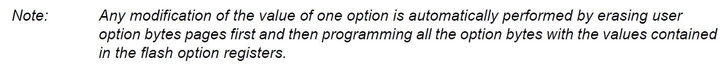

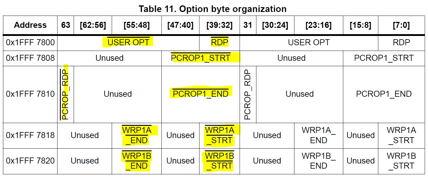

It is not published, but I suspect the OB are set on an internal flash page which is not accessible to the user. As with programming any flash, it is first erased entirely and then programmed. Presumably, changing any option bit could cause others to be corrupt if power gets reset.
Edit: actually, yes this is stated explicitly in the RM:

Also of note, to see if the option bytes really did get erased, you should be able to look at the complementary option bytes and see if they are the XOR of the real ones. If everything is 0xFF, it all just got left in the erased state, presumably due to power loss.

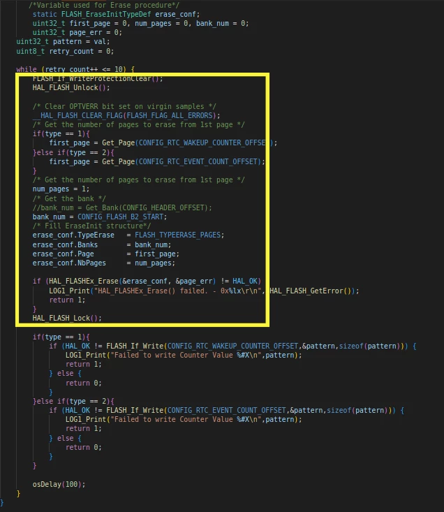

At the time of our testing, we observed that there is one custom API that is accessing a flash by configuring a few flash parameters. In this custom API for various flash operations we've kept retries as well. So in the worst/failure cases there are chances of performing flash operations more than once. Can you confirm while performing these operations, the MCU can trigger the flash lock if anything goes wrong? I have attached the screenshot below for our custom API code with the highlighted portion where our suspect lies.
Oh, actually let me walk back what I wrote, partially.
If a flash operation (non-option bytes) is interrupted, the option bytes should not be being modified. Only on option byte operations is this a possibility. So I don't think the code you posted could cause this.

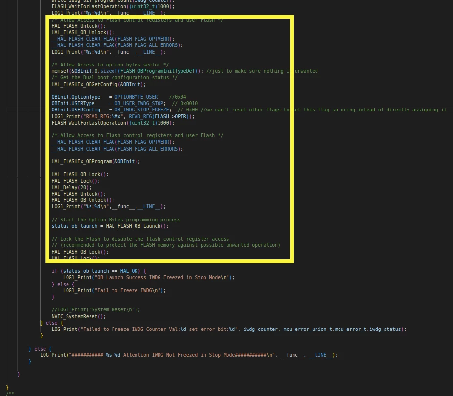

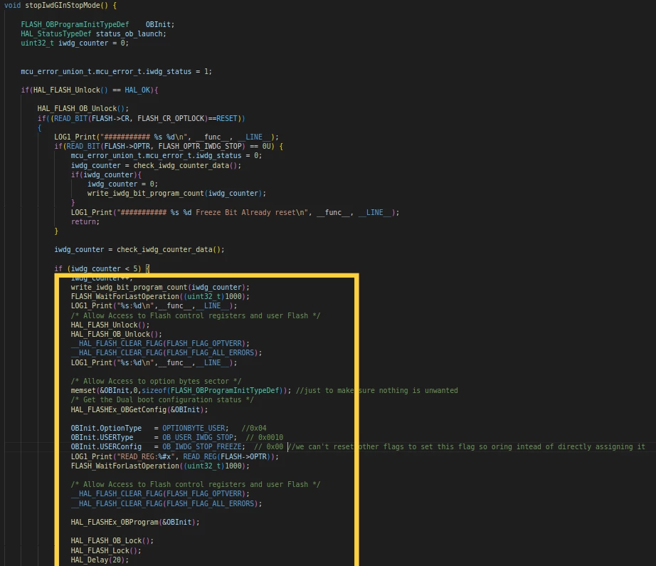

This is what I understood based on your clarification. If we perform memory operations other than the option bytes in shaky/low power, then MCU won't necessarily set the RDP. It comes into the picture only when something goes wrong during OB configuration. Please correct me if I'm wrong.
I've attached 2 screenshots where we are clearing the IWDG_STOP user OB flag. These operations are in the main function right when the MCU initialization happens. According to your clarification while performing these sequences there are chances to set RDP if anything goes wrong. Can you please confirm?
Also, the reason why we suspect on MCU chip to set the RDP rather than the code bug is that neither throughout this operation sequence nor in the whole software code did we touch OPTIONBYTE_RDP flag but instead used the OPTIONBYTE_USER flag. Do you think OPTIONBYTE_USER configuration can indirectly corrupt OPTIONBYTE_RDP?
Correct. Regular flash operations will not affect option bytes.
Correct.
Absolutely. Whenever ANY option byte is set, the entire option byte area is erased (including RDP and whatever else is in there), then reprogrammed. At the hardware level, they cannot be modified one at a time. See the excerpt above from the reference manual.
