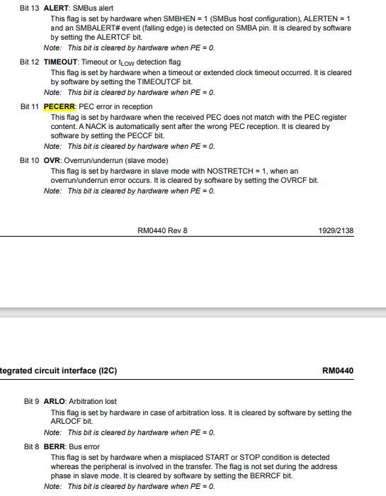

- On another note, it looks like the interrupts are not always cleared in accordance with **RM0440 Table 394**:
  - In the error section, I2C_FLAG_PECERR, I2C_FLAG_TIMEOUT, and I2C_FLAG_ALERT are never cleared.
  - Also in I2C_Master_ISR_IT.

Hello @photon
These flags "I2C_FLAG_PECERR, I2C_FLAG_TIMEOUT, and I2C_FLAG_ALERT" cannot be cleared by software. They are cleared by hardware when disabling the peripheral.

Jan 9, 2025 2:37 PM UTC
Hello @photon
For the moment, it is up to the user to manage the race condition on HAL access. This can be done using a software semaphore. By implementing a software semaphore, you can control access to the HAL, ensuring that only one process or thread can access it at a time, thus preventing race conditions.
In order to give better visibility on the answered topics, please click on 'Best answer' on the reply which solved your issue or answered your question. Saket_Om
