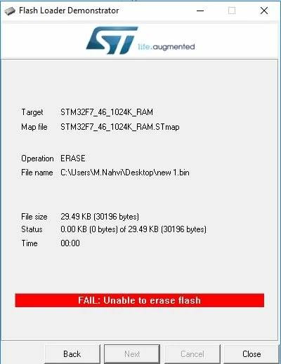

Hi, problem resolved.
I change STMap file as:

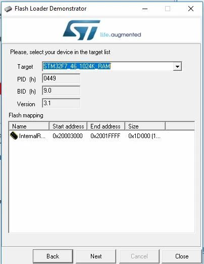

[Product]
Name=STM32F7_46_1024K_RAM
PID=0449
BID=1FF0EDBE
FlashSize=0400    ;;ADDR_FLASH_SIZE=FFFFFFFF;  TO BE DONE !!!!
PacketSize=80
ACKVAL=79
MAPNAME=Sectors
PagesPerSector=1
family = 6;
;; InternalRAM
[InternalRAM]
Name=userRAM
Address=20010000
Size=0001D000
Type=111
UFO=111

mn_it
Jun 21, 2017 5:29 PM UTC
Posted on June 21, 2017 at 17:29
Hi
I am going to program qspi flash using UART boatloader that can use for future update from internet,
My MCU is STM32F746BG, I change sample project of AN2606 and make new .bin file. but i can not program RAM of stm32f746 using flash loader.
i get Error: can not erase or can not download.
I change  .STmap file for my MCU:
[Product]
PID=0449
BID=1FF0EDBE
PacketSize=80
ACKVAL=79
MAPNAME=Sectors
PagesPerSector=1
family = 6;
;; InternalRAM
[InternalRAM]
Name=userRAM
Address=20003000
Size=0001D000
Type=111
UFO=111
what is wrong?
