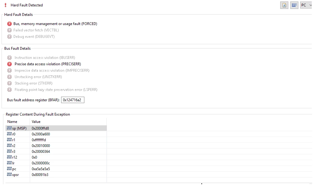

Hello ,
I am trying to implement PTP (IEEE1588) on stm32f107 I have used this code for reference
"https://github.com/mpthompson/stm32_f4_ptpd" and ported it to stm32f107
Now, Everything works fine if Time stamp register bit 0 is set to "0" ,i.e..
I can see the sync and announce packets in wireshark and the program is running with 0 timestamps , below attached is the debug2 for reference.
if Time stamp register bit 0 is set to "1" program halts with hardfault. with below debug 1 and attached is the image of what fault analyzer has to say.
Thanks For helping ...0693W000000UpfUQAS.png.

Got to look at the faulting code.
Presumably your code faulting, not the stuff on github.
Do you have the IRQHandler set up an named properly for your platform, check stm32f1xx_it.c

The PC/LR values in your prior post don't look valid/helpful.
Hard to diagnose with info presented. Might want to check the stack sizes, or try without the RTOS.
You need a proper Hard Fault Handler, and you need to look at the offending assembler instructions and processor registers.

> To my knowledge, it is not generating any interrupt and thus I don't need IRQHandler set up.
Look carefully at ETH_MACIMR register's reset state and bit description. Read more on this specific problem here:
https://community.st.com/s/question/0D50X0000AIdSc0SQF/unwanted-interrupts-for-ethernetmac-mmc
And overall on all Ethernet related problems here:
https://community.st.com/s/question/0D50X0000BOtfhnSQB/how-to-make-ethernet-and-lwip-working-on-stm32
