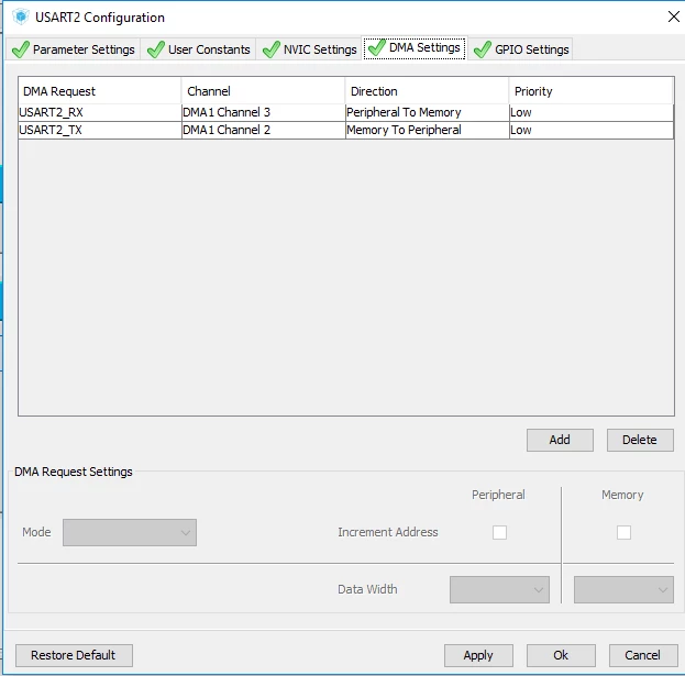

When generating code using LL libraries for an STM32L011F4Ux MCU, I found that enabling DMA for USART2 RX and TX and selecting DMA channels 2 and 3 makes the Cube create non working code.
I checked the RM for this MCU and at chapter 10.4.7 'DMA channel selection register (DMA_CSELR)' I saw that channels 2 and 3 are not the right ones for USART2.
Anyway, the Cube lets you select the right channels (i.e. 4 and 5) and, with those, everything seems OK.
Can you please check?

I confirm it is a bug and it will be fixed next release.
Thanksfor rising this problem.

Hello
Coccon.Andrea
You are right,I raised this issue internally to CubeMx team for fix.
Thank you for posting your finding.

I'm not able to reproduce the problem, can you please send me the ioc ?
What did you mean by '
non working code'? That there is compilation error?

Hi Houda,
the code generated doesn't work because 2 and 3 are not the right channels to set when using USART2 in DMA mode.
but, as you can see, Cube sets these channels when adding DMA.
Have a nice day,
Andrea
