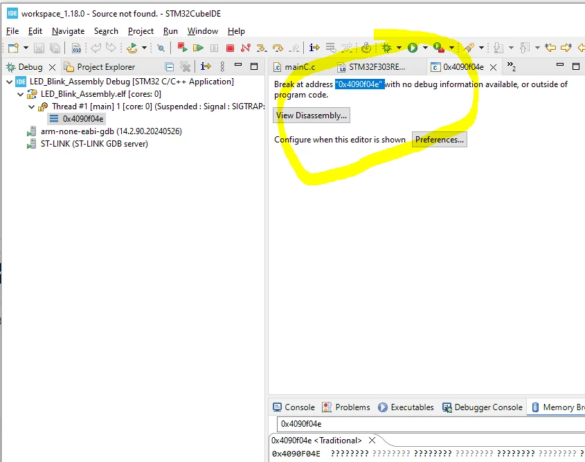

It will not work a) it blinks only once and gets stuck in hardware b) on Debug it yields the error below.
I tried the same 2 line code as suggested, but it gives the following error regardless on Debug. It will not go further from that undefined location obviously and debug quits.
Inserting extra breakpoints doesn't work since it crashes due to an error looks like an exception (an undefined location reference). I assume it is not the coding but rather a configuration problem, a misconfiguration of the stack etc. Same code works fine on Keil by the way.  Thank you.
