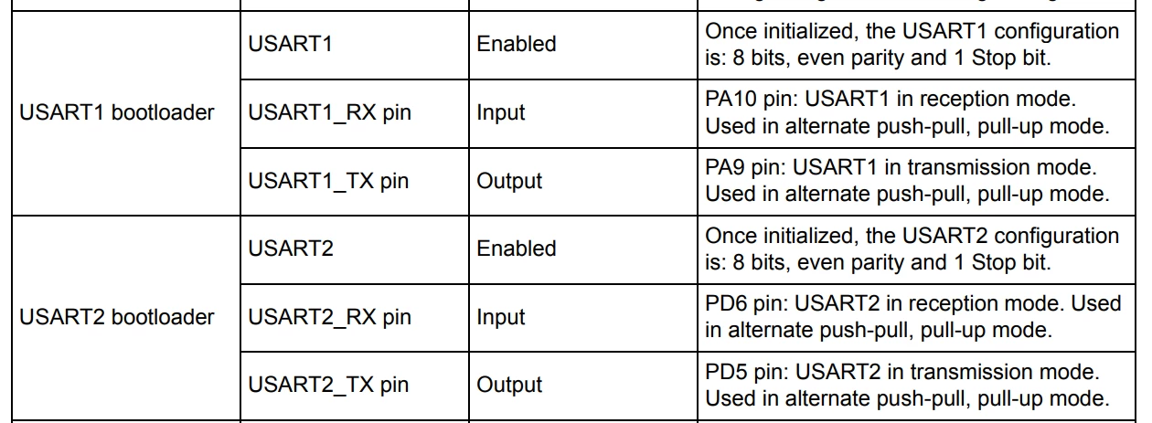

MM..1
Jan 27, 2023 7:11 PM UTC
ARama.9
ARama.9Author
Jan 27, 2023 7:13 PM UTC
yes. I used 9600 baud rate, 8 data bits, 1 stop, even parity and no flow control. Thanks
MM..1
Jan 27, 2023 8:46 PM UTC
L151 ? USART3 isnt in AN2606
