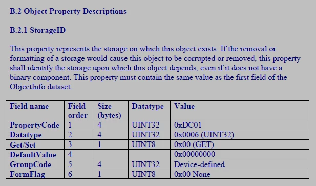

Main Question
How should GetObjectHandles be properly implemented in MTP so that Windows correctly displays a hierarchical folder structure?
I tried to read the Media Transfer Protocol v1.1, but I couldn’t find anything clearly useful for my case, probably due to my inexperience with this topic.
I will attach the full project to the post, but I’ll also include the modifications I’ve made to the ST example. I’ll try to list all of them, though I might miss some.

The problem occurs because there is a bug in the ST example, which contains an error causing the StorageID property description to be incorrect.
In the USBD_MTP_GetObjectPropDesc function, in the case UX_DEVICE_CLASS_PIMA_OBJECT_PROP_STORAGEID:
/* Fill MTP object property struct */
MTP_ObjectPropDesc.ObjectPropertyCode = UX_DEVICE_CLASS_PIMA_OBJECT_PROP_STORAGEID;
MTP_ObjectPropDesc.DataType = UX_DEVICE_CLASS_PIMA_TYPES_UINT16;
MTP_ObjectPropDesc.GetSet = UX_DEVICE_CLASS_PIMA_OBJECT_PROPERTY_DATASET_VALUE_GET;
MTP_ObjectPropDesc.DefValue = (uint8_t *)&storageid;
MTP_ObjectPropDesc.GroupCode = 0U;
MTP_ObjectPropDesc.FormFlag = 0U;
It is necessary to change:
to:
MTP_ObjectPropDesc.DataType = UX_DEVICE_CLASS_PIMA_TYPES_UINT32;
This was causing MTP to not recognize my storage correctly, and therefore it could not detect that the storage had a hierarchical structure.
The correct way to describe this parameter is specified in the Media Transfer Protocol Specification Revision 1.1 (April 6, 2011), Appendix B, section B2.1.
to:
