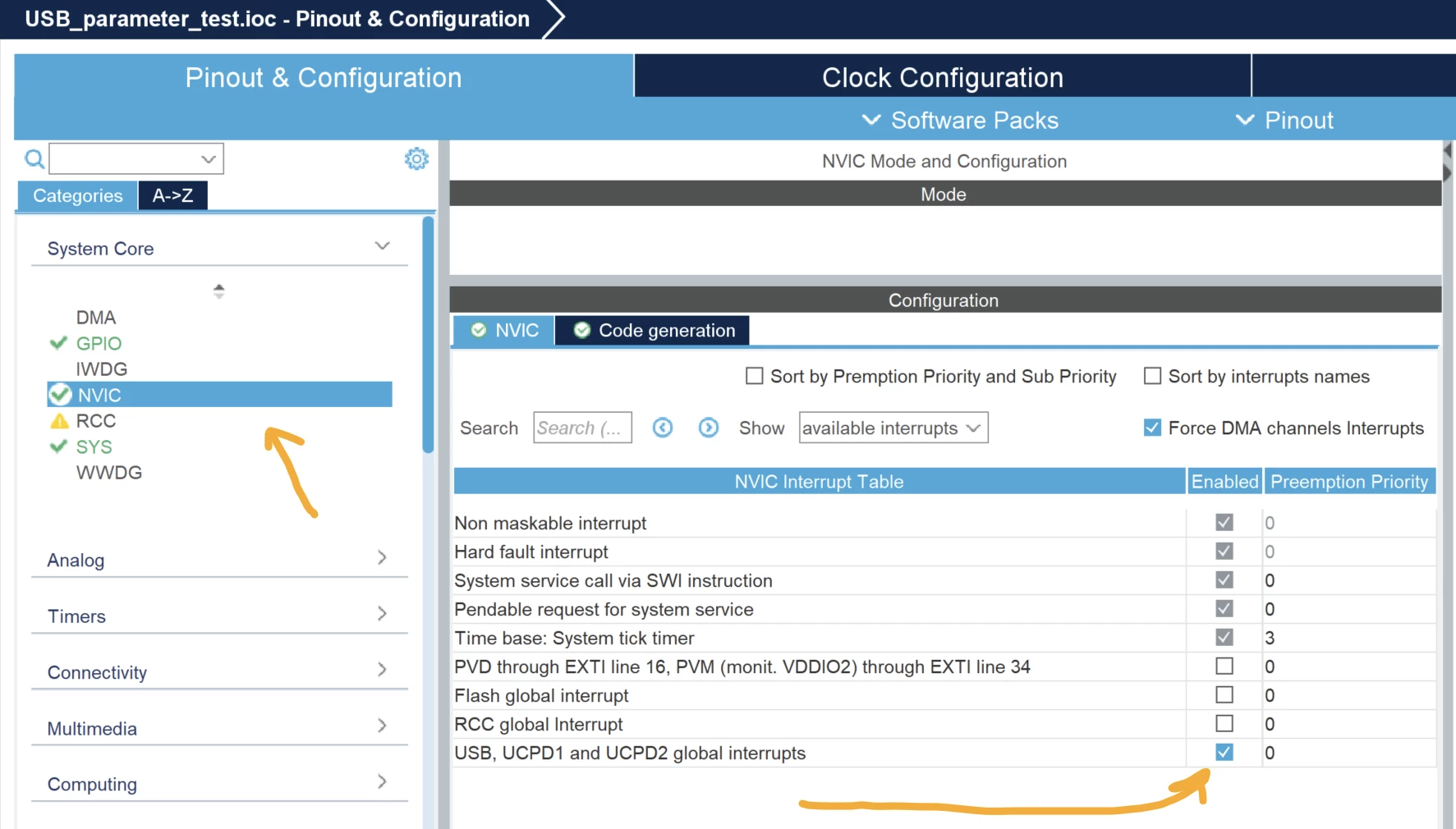

I had some issues setting up my STM32G0B1CET6N as USB Communication Device Class (Virtual Port COM).
Clock Source for the USB is the internal "HSI48 RC" oscillator, designed for USB application.

I used the default USB Settings (default USB STMCube MX generated).
I started debugging (step by step) and came to the
MX_USB_Device_Init();
function inside the main.c

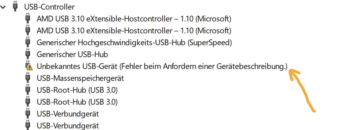

Then I open the Windows11 "Gerätemanager (Device Manger)" and the USB device always failed to get recognized.

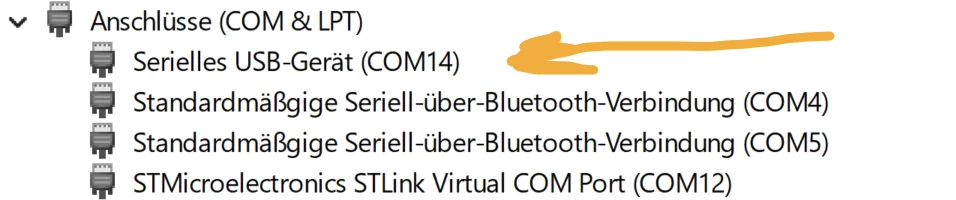

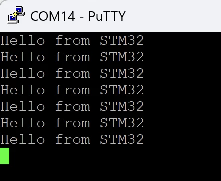

I relaunched the debugger and this time I just klicked on the "Run" button. No step by step debugging this time. The STM32 gets recognized as a COM device without any problem.
And the communication (sending data to the putty terminal) works without any problem.

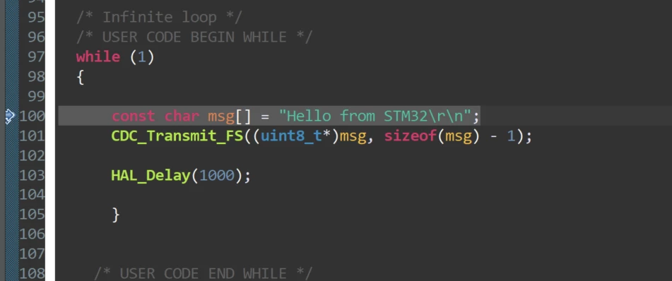

However when adding a debug breakpoint (for example in the while(1) loop) the STM32 gets no longer recognized as a COM device anymore.
Same problem as before:
I don't think that's altogether unexpected?
By putting a breakpoint, you will disrupt the comms between the USB Host (your PC) - which could well cause the failure.
So is this a bug? Or is it simply not possible to have a working STM32 COM-device when working with the debugger?
You have to be very careful about breakpoints withing timing-critical code!
Is this problem caused by the fact, that the USB works via Interrupt and interrupts fail in the debugger?
It's not that they fail as such - but halting the core may cause deadlines to be missed.
This isn't specific to STM32 - it's an inherent limitation of halting debug.
Segger have a clever trick to help in these situations but, IIRC, not on Cortex-M0:
https://www.segger.com/products/debug-probes/j-link/technology/monitor-mode-debugging/
