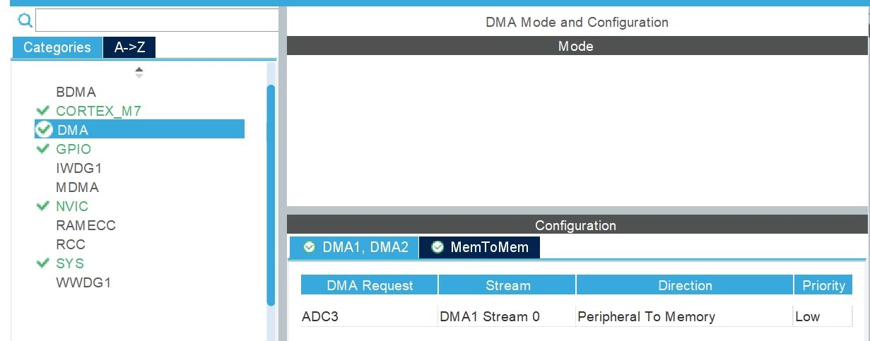

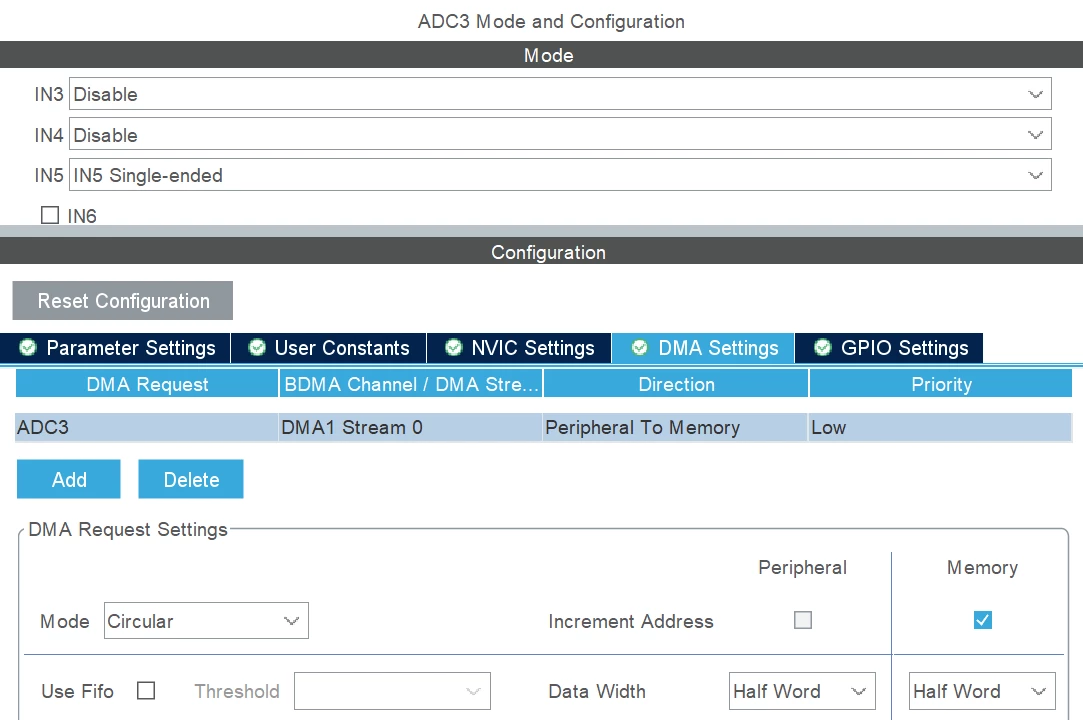

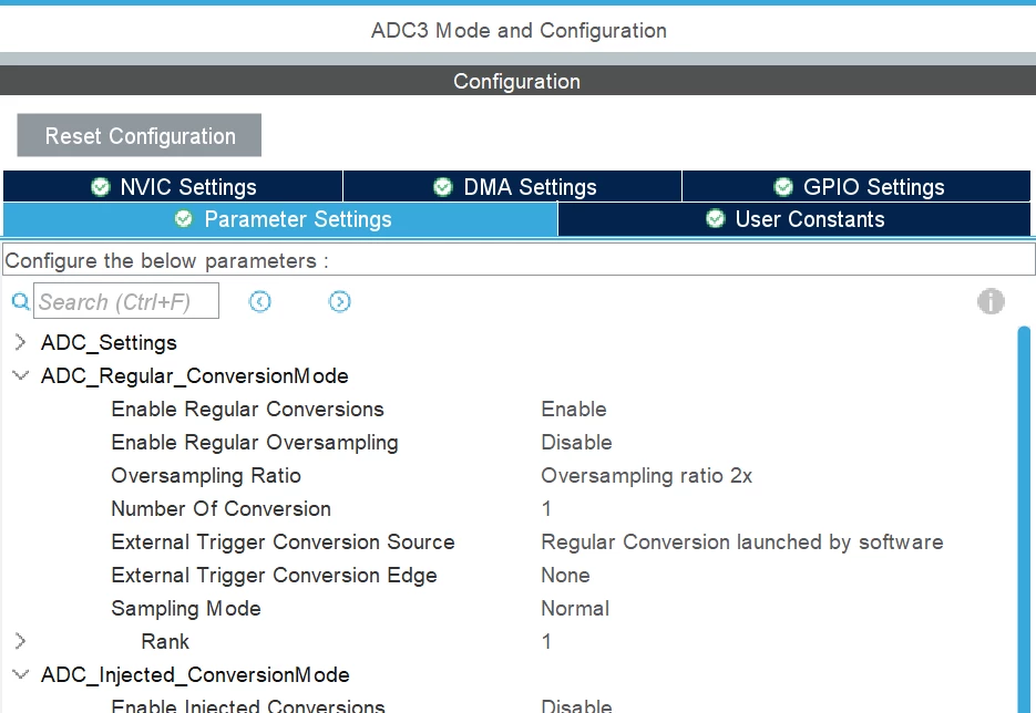

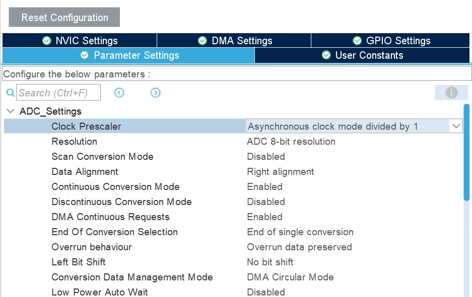

Board: NUCLEO-144 STM32H723ZG
I'm using ADC_3 with 8-bit resolution, trying to measure an analog sine wave of 1 kHz as a stimulus.
I'm trying to use the ADC with DMA. However, I am unable to get any values other than zero. I have tested it in polling mode and have successfully gotten correct values. I have been looking at multiple code examples. It seems like HAL_ADC_START_DMA should be enough to start sampling; however, my buffer isn't being updated. Where have I gone wrong?
DMA settings
ADC DMA settings
ADC_settings
ADC_regular_conversionMode
CODE:

 HAL_ADC_Start_DMA(&hadc3,&adc_val, 2);

 ADC_ChannelConfTypeDef sConfig = {0};
 /* USER CODE BEGIN ADC3_Init 1 */
 /* USER CODE END ADC3_Init 1 */
 /** Common config
 hadc3.Instance = ADC3;
 hadc3.Init.ClockPrescaler = ADC_CLOCK_ASYNC_DIV1;
 hadc3.Init.Resolution = ADC_RESOLUTION_8B;
 hadc3.Init.DataAlign = ADC3_DATAALIGN_RIGHT;
 hadc3.Init.ScanConvMode = ADC_SCAN_DISABLE;
 hadc3.Init.EOCSelection = ADC_EOC_SINGLE_CONV;
 hadc3.Init.LowPowerAutoWait = DISABLE;
 hadc3.Init.ContinuousConvMode = ENABLE;
 hadc3.Init.NbrOfConversion = 1;
 hadc3.Init.DiscontinuousConvMode = DISABLE;
 hadc3.Init.ExternalTrigConv = ADC_SOFTWARE_START;
 hadc3.Init.ExternalTrigConvEdge = ADC_EXTERNALTRIGCONVEDGE_NONE;
 hadc3.Init.DMAContinuousRequests = ENABLE;
 hadc3.Init.SamplingMode = ADC_SAMPLING_MODE_NORMAL;
 hadc3.Init.ConversionDataManagement = ADC_CONVERSIONDATA_DMA_CIRCULAR;
 hadc3.Init.Overrun = ADC_OVR_DATA_PRESERVED;
 hadc3.Init.LeftBitShift = ADC_LEFTBITSHIFT_NONE;
 hadc3.Init.OversamplingMode = DISABLE;
 hadc3.Init.Oversampling.Ratio = ADC3_OVERSAMPLING_RATIO_2;
 if (HAL_ADC_Init(&hadc3) != HAL_OK)
 Error_Handler();

static void MX_DMA_Init(void)
 /* DMA controller clock enable */
 __HAL_RCC_DMA1_CLK_ENABLE();
 /* DMA interrupt init */
 /* DMA1_Stream0_IRQn interrupt configuration */
 HAL_NVIC_SetPriority(DMA1_Stream0_IRQn, 0, 0);
 HAL_NVIC_EnableIRQ(DMA1_Stream0_IRQn);

Karl Yamashita
Principal
Jun 21, 2025 12:13 AM UTC
You need to calibrate the ADC before starting the DMA
HAL_ADCEx_Calibration_Start(&hadc3, ADC_CALIB_OFFSET /* or ADC_CALIB_OFFSET_LINEARITY*/ , ADC_SINGLE_ENDED);
If a reply has proven helpful, click on Accept as Solution so that it'll show at top of the post.CAN Jammer an open source CAN bus hacking toolCANableV3 Open Source

@_summer_intern_
I missed it earlier but I see that you have Continuous Conversion Mode enabled. In previous projects, I observed that this will cause interrupts continuously to the point the ADC can't do a conversion correctly.
So I did a test again and I was able to replicate your issue with ADC1 with Continuous Conversion Mode enabled. It was reporting 0, as you've indicated.
To fix it do this. I created a 100ms interrupt timer to trigger the ADC conversion.
1. In ADC, disable Continuous Conversion Mode
2. Enable a timer like Timer15.
  1. Enable Internal Clock.
  2. Enable auto-reload preload
  3. Set Trigger Event Selection for Update Event.
  4. Set period (and Prescaler) to a value to get interrupts like between 100ms to 1us. Anything faster might be too much overhead, but then it also depends on your clock speed.
3. Now in ADC,  set External Trigger Conversion Source to Timer 15, Trigger Out Event
I missed that, too.
Probably because the idea doesn't make too much sense in the first place - continuous single-channel conversion with DMA.
The "old" SPL examples mostly used continuous conversion, pushed the value in a buffer variable, and the main loop read at irregular intervals.
