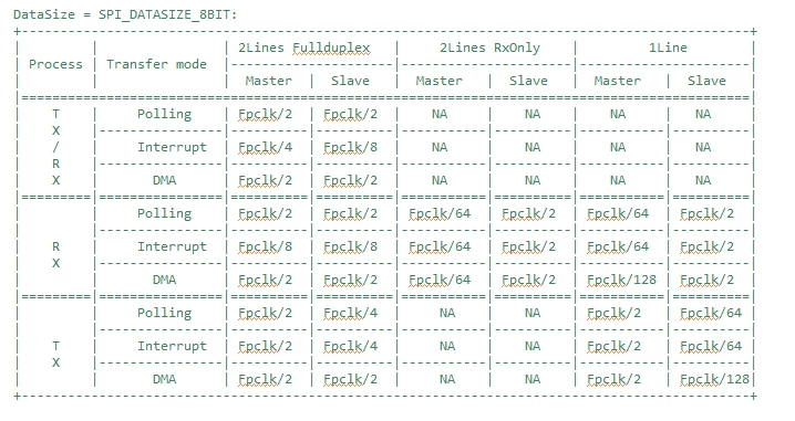

Feb 11, 2025 4:17 AM UTC
@Saket_Om Thanks for your reply. This image shows the clock configuration for spi protocol as per this I have set my peripheral clock after this also I didn't get the correct byte from slave side. could you please cross check my edited code and put your views on this.

Hello @adityatiwari
You should use HAL_SPI_TransmitReceive_IT() in the Master side and also in the slave side.
Please check the example Projects/STM32F4-Discovery/Examples/SPI/SPI_FullDuplex_ComIT and update your code.
