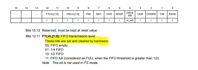

1. It it possible to clear Tx FIFO??
"FTLVL" It's not '0' value. how to make '0'?

Hello @MartinK
There is no possibility to clear these bits by software. these bits are fully managed by hardware. Please take a look at the description provided in the reference manual below.
