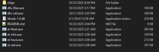

Ivaylo Ilchev
Oct 26, 2025 11:31 AM UTC
There is a problem if a driver from the dfuse package was previously installed. In this case, it must be uninstalled by deleting the files. I put this in the package I made for internal use with st-link tools, dfu-util and and a tool that converts hex to dfuse, dfu-files. BTW all the tools and chips folder is 1.75MB, zip is 665kB. :)
## Troubleshooting
- Probe won’t connect / "No ST‑LINK detected":
 - Ensure only one tool accesses the probe (close CubeProgrammer, IDEs, or GDB servers).
 - Install the WinUSB driver for the ST‑LINK interface using Zadig:
 1. Download Zadig, run it as admin.
 2. Options → List All Devices.
 3. Select "ST‑Link Debug" (or similar interface), choose `WinUSB`, click Install Driver.
 - Try `--connect-under-reset` and/or `--hot-plug`.
 - Lower the speed: `--freq 400k`.
- Unknown device / flash size is 0:
 - You might be running an unsupported or very new MCU — update the tools or the `chips/` database.
 - Make sure the target has power and the BOOT pins aren’t forcing a different mode.
- DFU upload/download fails:
 - Confirm the device is in DFU mode (check with `dfu-util -l`).
 - Use the correct alt‑setting (`-a`) and address (`-s 0x08000000:leave`) for raw binaries.
