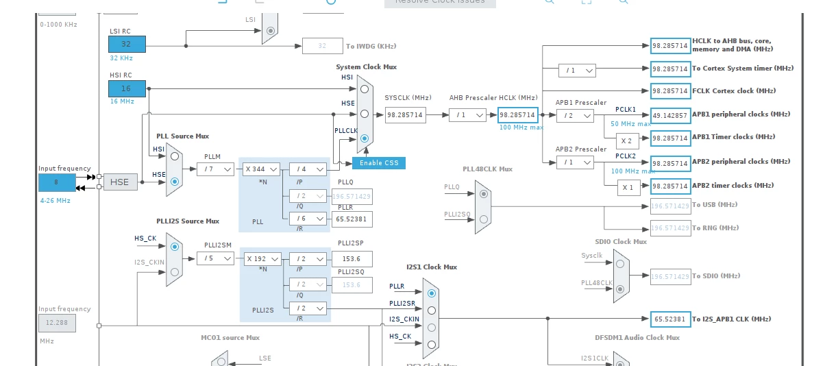

Hello, i would like to know how to use your PDM2PCM middleware for 2 microphones processing data, if you have some examples for it - it would be perfect.
I was able to get the good sound for mono(with 1 mic) when i get the board for stereo sound, i can not get the proper sound signal.

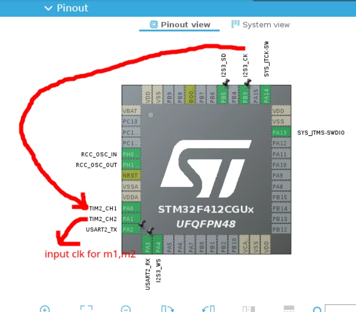

Microphones are connected using i2s peripheral.
I'm using my custom board with 2 IMP34DT05TR PDM MEMs microphones.

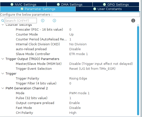

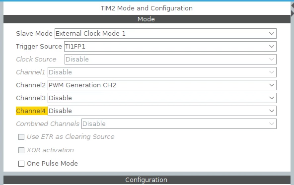

Also it is interesting how TIMer code for stereo microphone should look (when should i start the timer and in which mode ?)
MCU: STM32F412CGU6
Micros: IMP34DT05TR

 HAL_TIM_PWM_Start(&htim2, TIM_CHANNEL_2);
what i'm doing now - trying to start the timer with such start function.
Clock configurations done according to Interfacing PDM digital microphones using STM32 MCUs and MPUs - Application note.
Timer settings in attachment
Please share your advice or maybe code example for using such PDM stereo micros with your PDM2PCM middleware and CubeMX
