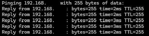

May 6, 2024 10:59 AM UTC
Hello @STea
Again started working on the ethernet and LWIP.
I am now able to ping the static IP using LWIP, stm32cubeIDE version : 1.15.1 stm32CubeMX version 6.11.1 with FreeRTOS CMSIS V1 and TouchGFX.
But still not able to transfer data using ethernet.
Also wanted to know is there any example of data transfer using ethernet without LWIP just by using raw APIs.
Thankyou.
