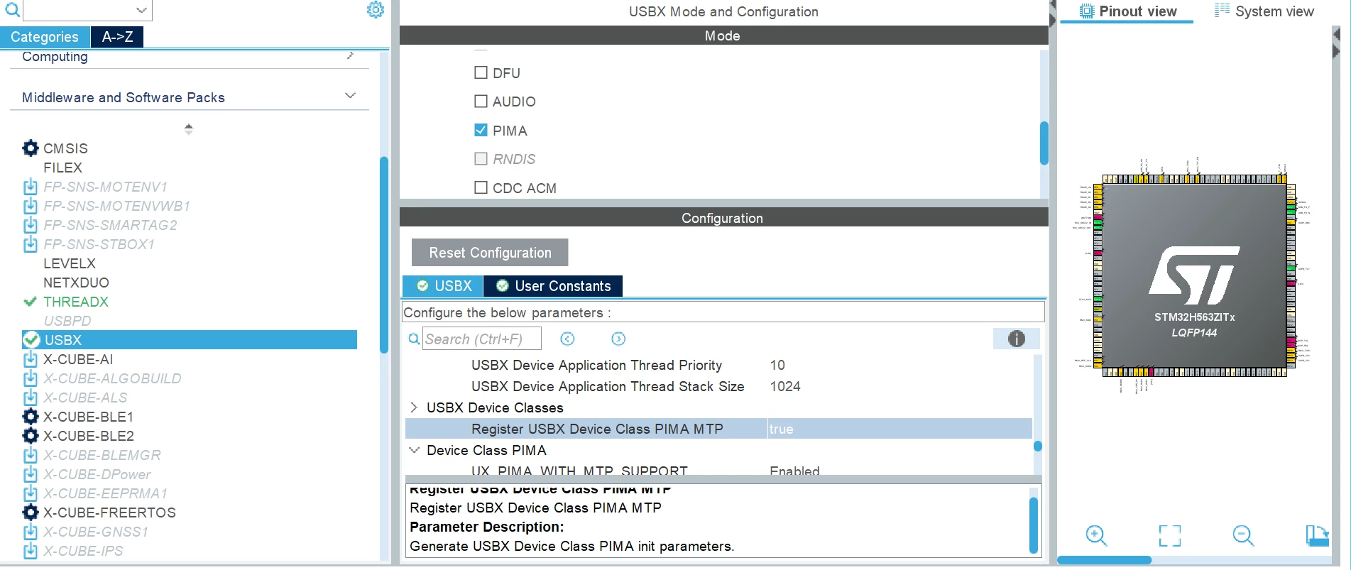

  1. Some products have this flexibility to use USBX without ThreadX.
  2. Indeed, using H5 you can build USBX standalone application by simply unchecking ThreadX checkbox under Middleware and Software Packs
  3. Using USBX stack, MTP class standalone is defined as PIMA MTP in device mode.

https://github.com/STMicroelectronics/stm32-usbx-examples/tree/main/Projects/STM32H735G-DK/Applications/USBX/Ux_Device_PIMA_MTP
