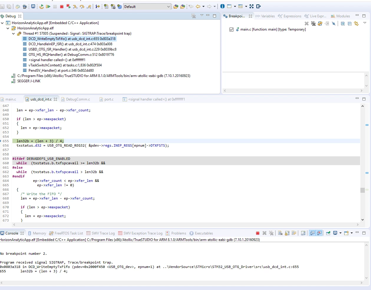

ST usb VCP driver gets stuck inside ISR on windows 10
Hi, we are using the an old USB driver from ST micro, and it works on windows 7. However, when we tried on windows 10 it gets stuck inside and ISR. Attached is the call stack.
Anyone has seen this issue? Where can I get the latest driver?

I dont have any trouble, except that in device manager, I can see sometimes it does not connect correctly. I have to hold reset for a few seconds, and release, check device manager...
I stopped using the VCP and used a spare uart to Max232 to an external USB converter, which remains connected during a board reset... for development, the VCP is still up and running just not connected to the PC
