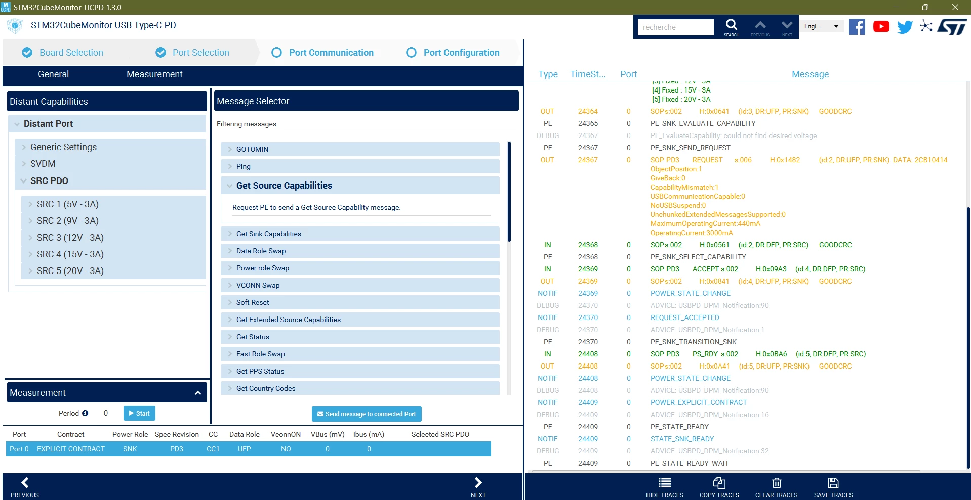

Im trying to get a USB PD 3.0 connection betwe en an ST X-Nucleo-DRP1M1() and an power bank or wall adapter.
If i ask for the source to give its capabilties, and set up an 5, 9,12, 15 or 20V Vbus voltage the nucleo says it has an capability mismatch. Also it says it can only handle an maximum operating current of 440mA. But i cant find that number anywhere. My SNK_PDO list is as following:

Unfortunately no, CubeMX isn't able to configure this automatically, as this is highly applicative. I'll suggest you to add trace in the PDO request function DPM_SNK_BuildRDOfromSelectedPDO. It is the function that will create the RDO, and it should give you hints about why is there the 440mA value.
For debug, can you try also with defining only one Sink PDO (5V 3A) (in usbpd_pdo_defs.h) to see if the second one (also 5V) is disturbing the RDO building process ? Having multiple PDO of the same voltage is not allowed by the PD spec.
See spec 3.1 rev 1.8:
Chap 6.4.1.3 Sink Capabilities Message
[...] A Sink Shall Not offer multiple Power Data Objects of the same type (fixed, variable, Battery) and the same Voltage but Shall instead offer one Power Data Object with the highest available current for that Sink capability and Voltage. [...]
In your case you should only have one Sink PDO 5V 3A, and play with the operating current field of the RDO to tell that you will draw 100mA. You will anyway tell the source that your maximum draw is 3A, and it has to accept it to have a contract.

Could you check that DPM_USER_Settings[PortNum].DPM_SNKRequestedPower.MaxOperatingCurrentInmAunits in is effectively set to the value you expect ?

It seems like that value hasnt been configured. Should this be done automaticly via CubeMX?
If set it to 3000, it will still display 440mA as the max current

Thanks, only having one 5V sink PDO helped. Also I had to erease my board memory with STCubeprog before the changes seem to be accepted.
