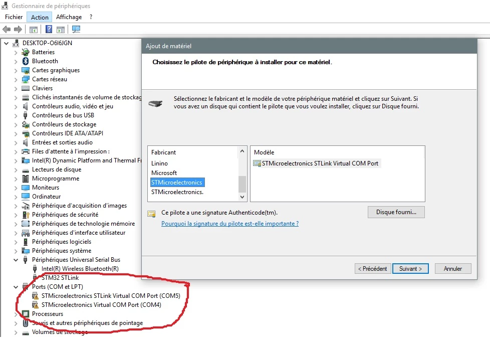

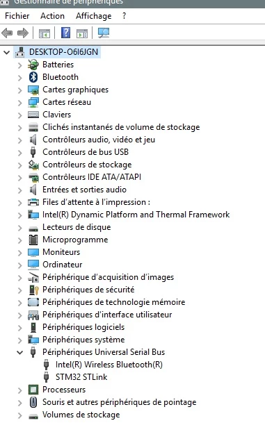

The driver
http://www.st.com/en/embedded-software/stsw-link009.html
creates only the a USB serial port as shown here :
So i try to add the Virtual Port Com Manually with the action ''add an old generation device'' in the Device Manager
I try to install the STMicroelectronics\STM32 ST-LINK Utility\ST-LINK_USB_V2_1_Driver\stlink_VCP.inf
or the STMicroelectronics\Software\Virtual COM Port Driver
or the STMicroelectronics\Software\Virtual comport driver\Win8
Even after removing one by one, and reinstalling one at times, no one is working
I try all the possiblities listed in many chats or forums
I also attach the USBView devices listing
Is there a new update for the 1.4.1 VCP Driver for windows 10 ?

Hi
Moualek.Nassim
In Windows 10, USB driver has been reworked and there is no need for Virtual COM driver to be installed. It works natively when you plug-in a device. But according to Microsoft documentation, you need to set device USB class and subclass ID to 0x2 (see
https://msdn.microsoft.com/en-us/library/windows/hardware/dn707976(v=vs.85).aspx
This should be fixed in the HAL/CubeMX examples.
Best regards,
Cedric
