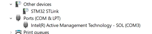

Hello, I am having trouble connecting my nucleo board to my pc because the port is not being recognized. I downloaded the st-link 009 usb driver without any problems but when i connect the board the com port and the device doesnt show up. In the description it says its compatible up to Windows 10 but I read on other forums that people with windows 11 did get theirs to work. I'm not getting errors its just not showing up. What am I missing?

Did you try the same config with another machine (USB cable+STLink probe) with Windows 10?
Are you sure your cable is a data cable and not a charging cable?

Mar 27, 2024 3:35 PM UTC
Thank you, I was indeed using a charging cable and not a data cable!

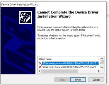

I am facing same issue, So i am trying to install st-link-009 driver, this also not getting installed, ports are not recognized in windows 10

Hello @Angel12345 and welcome to the community,
This is not the same issue. So, please open a new thread as this was closed and describe your exact steps to reproduce the behavior.
Thank you for your understanding.

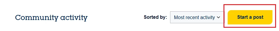

ok, I am new here, dont know how to open, if you know solution, let me know, what could be done
Click on that button on the home page of the community.
Also review tips in this link on how to post a thread.
