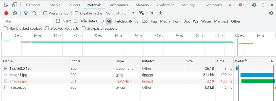

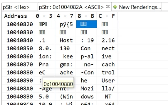

But when the code below was called for “image2.jpg�? I found “buf�? is normally corrupted with leading zeros.
netbuf_data(inbuf, (void**)&buf, &buflen);
Looking at the “buf�? I can see the original HTTP request, but the ETH driver/DMA/?? has overwritten the start with zeros.

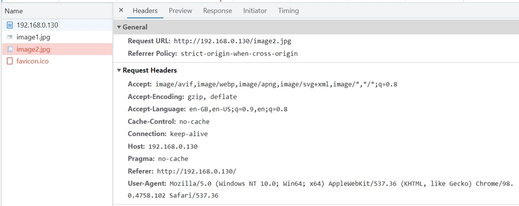

0693W00000KbQfsQAF.jpgLooking at the web browser I can see the actual request is valid.
0693W00000KbQgmQAF.jpgWhen the web server sees an empty string it returns back with 501, and the image is not loaded.

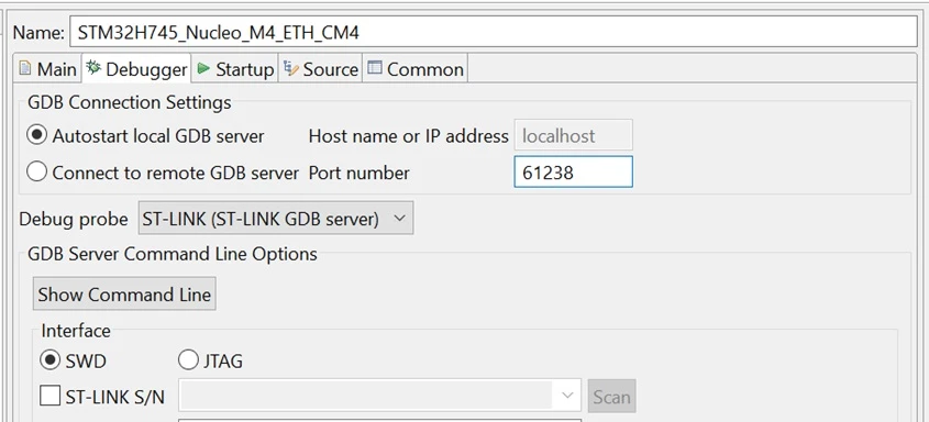

I’ve included the whole project as a zip file. If you debug it you need to change one of the debug configurations to use a different GDB port number, eg 61238, otherwise it will clash.

Probably too late to answer this ticket, sorry, but it might be useful for someone who has similar issue:
It seems that is the same major bug on the old driver RX data corrupted and it was resolved in the new one but when downloading test case attached to the ticket it seems to be still using the old Ethernet driver despite the fact you talk about using the new driver.
https://community.st.com/s/question/0D50X0000C6eNNSSQ2/bug-fixes-stm32h7-ethernet

Feb 12, 2023 5:58 PM UTC
Hi @CHossack​
What I mean is that: if you use now, the updated STM32H7 CubeFW latest version and the latest version of STM32CubeMX you should not see that issue.
