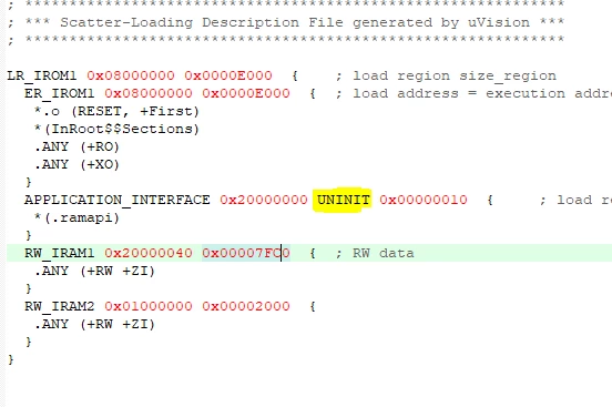

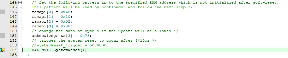

I have a problem with the SRAM. I use a stm32f303CCT and Keil. I write  a value in the SRAM memory. (0x20000000 - 0x20000008) However, after a soft reset, the SRAM value will be deleted. How can this be prevented so that the data is preserved?
The data is stored as shown in the image below.
After soft reset the SRAM is deleted.
What do I need to change in the Patter File or the startup File so that the data is not lost?
Thank you for help

Doesn't Keil use NOINIT  not UNINIT

 In the "Options for Target" there is a box "NoInit" and Keil generates the UNINIT in the scatter file.
The line with UNINT should actually work, but the RAM memory area is always deleted after the software RESET.
The link https://mcuoneclipse.com/2014/04/19/gnu-linker-can-you-not-initialize-my-variable/ is only suitable, if you use the stm32CubeIDE program. At Keil the scatter file has a different syntax.

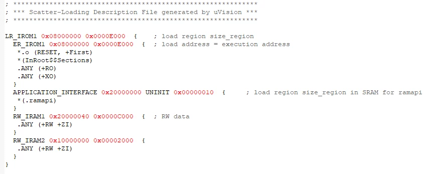

PHolz.1
PHolz.1Author
Dec 7, 2023 8:59 AM UTC
Thanks for your help. I solved my problem using the following link
https://developer.arm.com/documentation/ka003046/latest
I made the declarations like in Compiler 5, but I have Complier 6. So the declaration must look like this:
