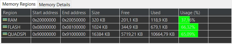

I want to split the .BIN file because it is too big... Here is the size of the files :
  • .BIN size : 2.13 Go
  • .HEX size : 30.5 Mo
  • .ELF size : 11.4 Mo
Here is the memory used :
0693W000006EImtQAG.pngI am using an USB flash drive to update my system program. I know I need to split .BIN file into multiple files which can describe multiple regions. I can use FromELF to do this but I don't know how to use it...
Could you help me ?

I used the example of "STM32Cube_FW_F7_V1.16.0\Projects\STM32756G_EVAL\Applications\USB_Host\FWupgrade_Standalone" (you can see my other post).
First of all, I want to update only the FLASH/RAM section. Then, if the FLASH/RAM works, I will try to update the QSPI section.
How can I use FromELF to separate this two sections ?

Did you ever figure this out? I'm trying to do the same thing and like you mention I can separate out the external flash part fine but then application is left with the 2GB of 0's.
Thanks
psilvaggio
Oct 31, 2023 7:26 PM UTC
I don't know if this will fix your issue, but I was able to separate the internal and external successfully without a 2GB large internal file. It was using a command similar to @MMerc.1 .At least with my project, I had an additional section in my external flash "FontFlashSection", so that section needed to be removed from the internal flash file and added to the external flash section. If I neglect to do this, I get the 2GB size internal flash size bin file.
arm-none-eabi-objcopy.exe -O binary --only-section=ExtFlashSection --only-section=FontFlashSection "${BuildArtifactFileBaseName}.elf" ExternalFlash.bin;arm-none-eabi-objcopy.exe -O binary --remove-section=ExtFlashSection --remove-section=FontFlashSection "${BuildArtifactFileBaseName}.elf" InternalFlash.bin
